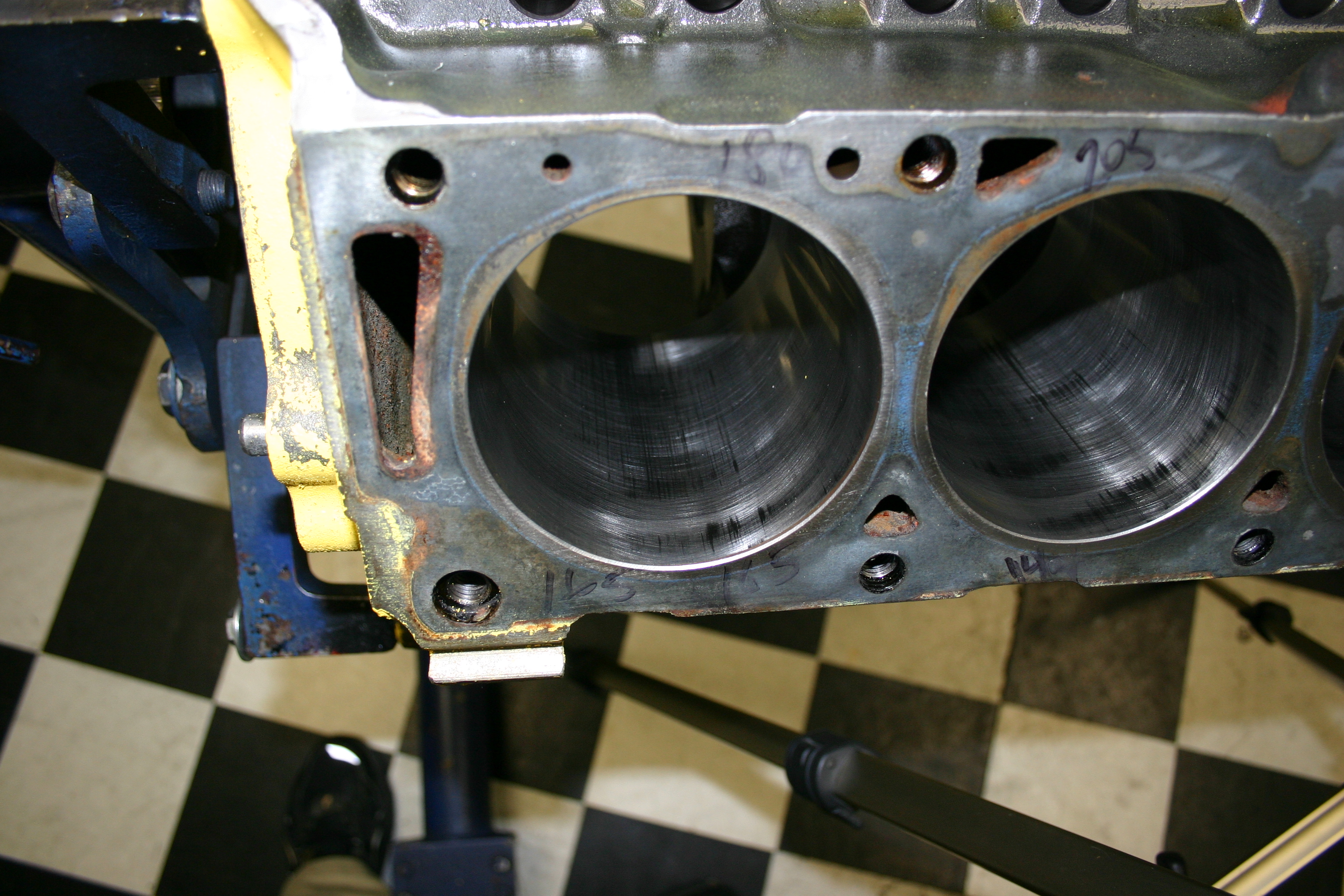

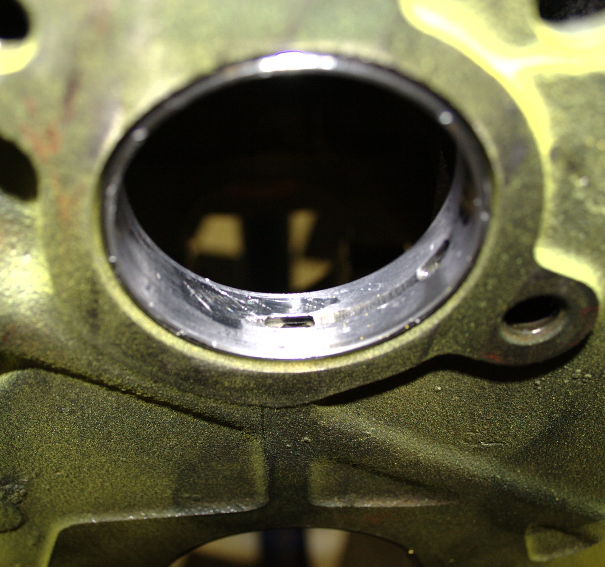

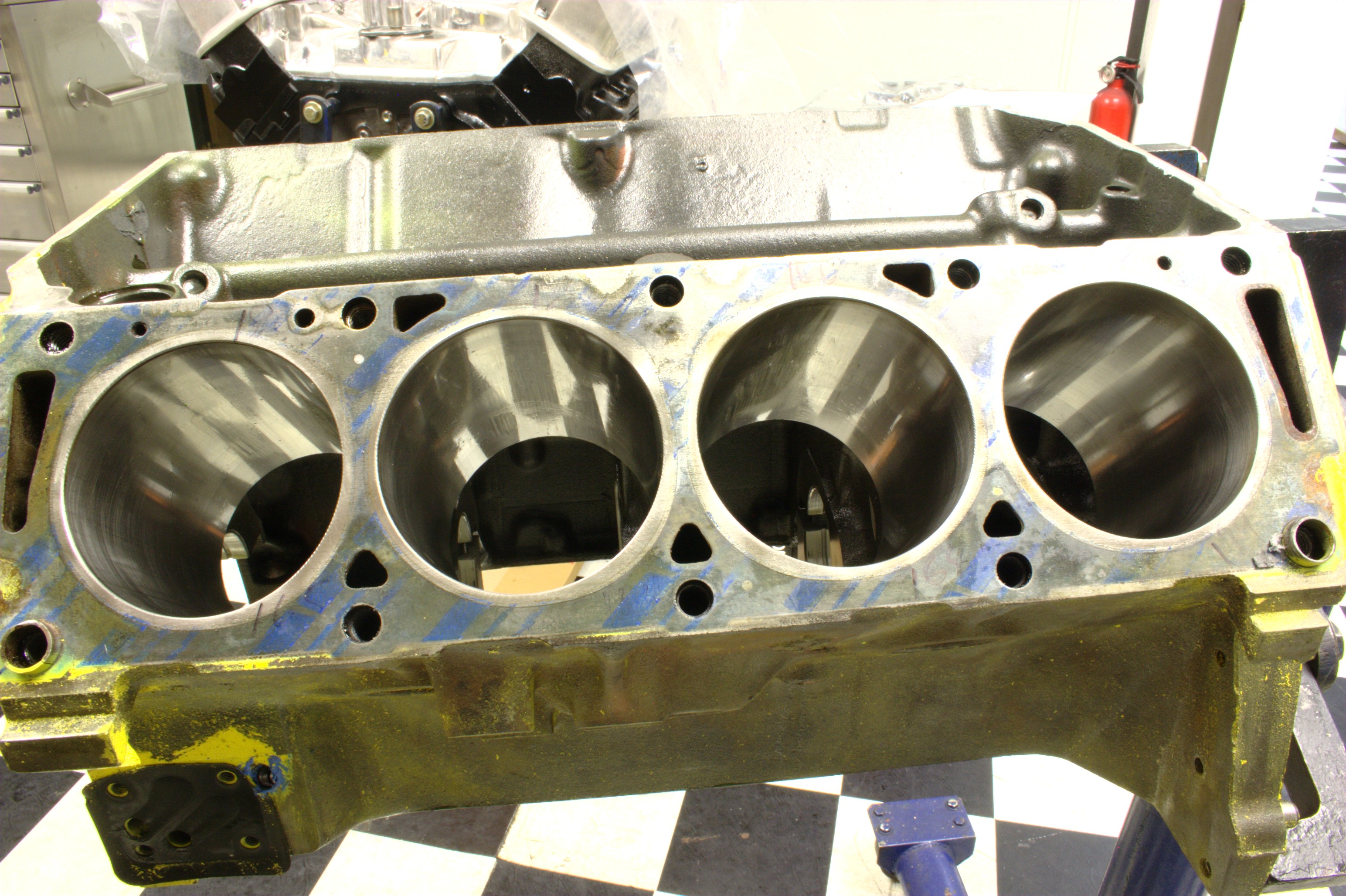

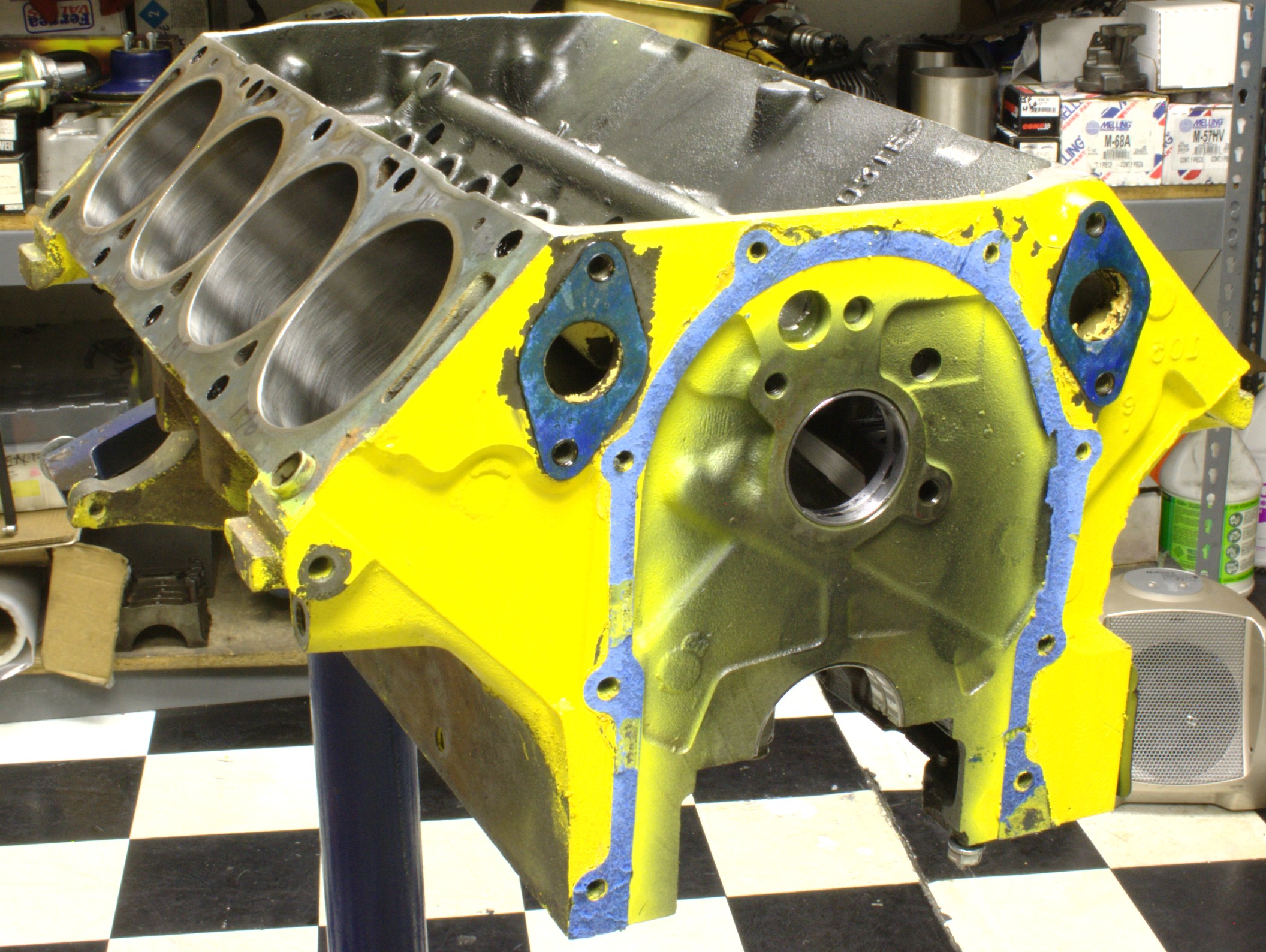

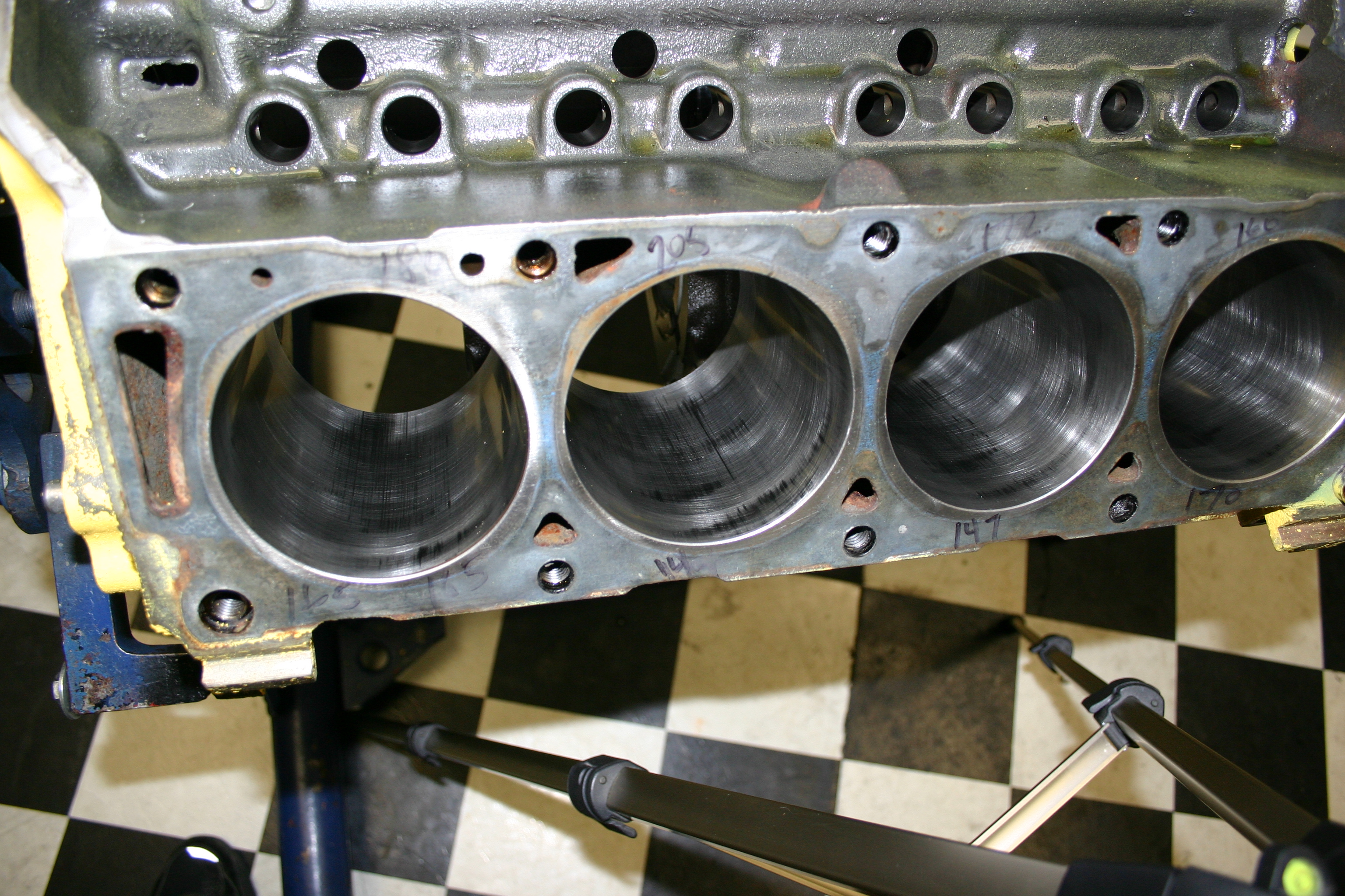

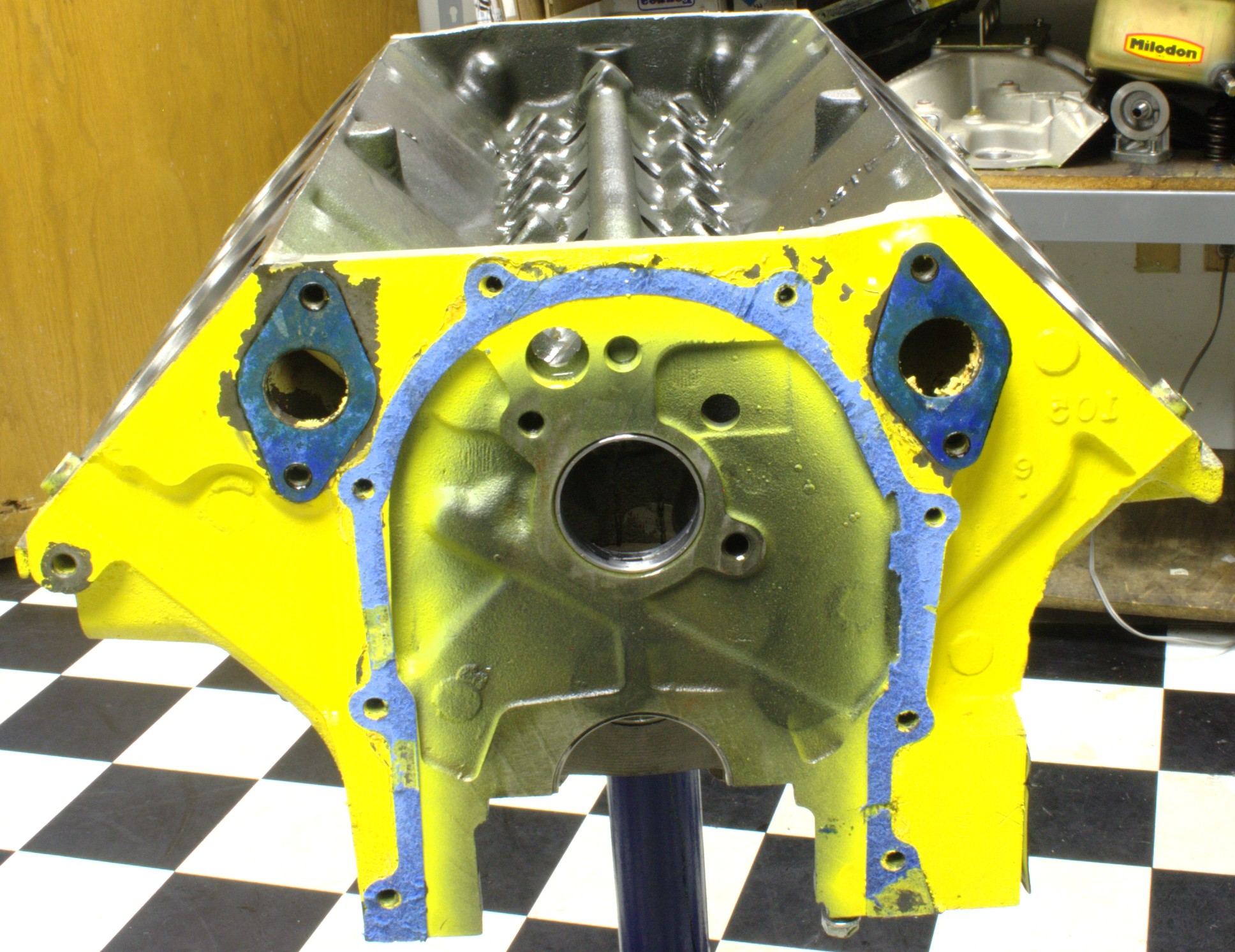

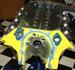

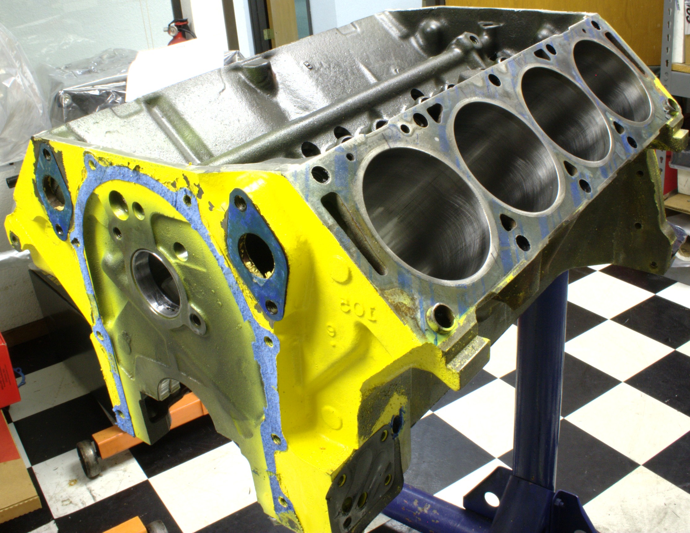

WOW. Those cylinders look absolutely terrible! I'm really at a loss for words.
Joe

fomocoguy wrote:WOW. Those cylinders look absolutely terrible! I'm really at a loss for words.
The wear is on the thrust side of the bore. Possibly piston rock from excessive piston/cylinder wall clearance.
That's exactly what I was thinking.
Robroy, how did the pistons look? Were they as worn as the cylinders? It's really a double edged sword; if they look old and worn then they weren't replaced; if they look new and shiny then they were replaced but put into worn old cylinders. Wow. Just wow.
One thing is for sure, wear like that doesn't happen in a half hour of run time unless the tolerances are WAAAY out of spec.
OK! It's good to know that they look bad to you too. I haven't seen a lot of cylinders in my day, although I did notice that on the engines Tom is building, the cylinders have a pristine, mirror-smooth finish.
BobbyFord wrote: The wear is on the thrust side of the bore. Possibly piston rock from excessive piston/cylinder wall clearance.
Good observation! You're probably right, although come to think of it, I'm not sure if I got any photos of the other side of the cylinders (the "roof" of the cylinders, based on how the engine was positioned).

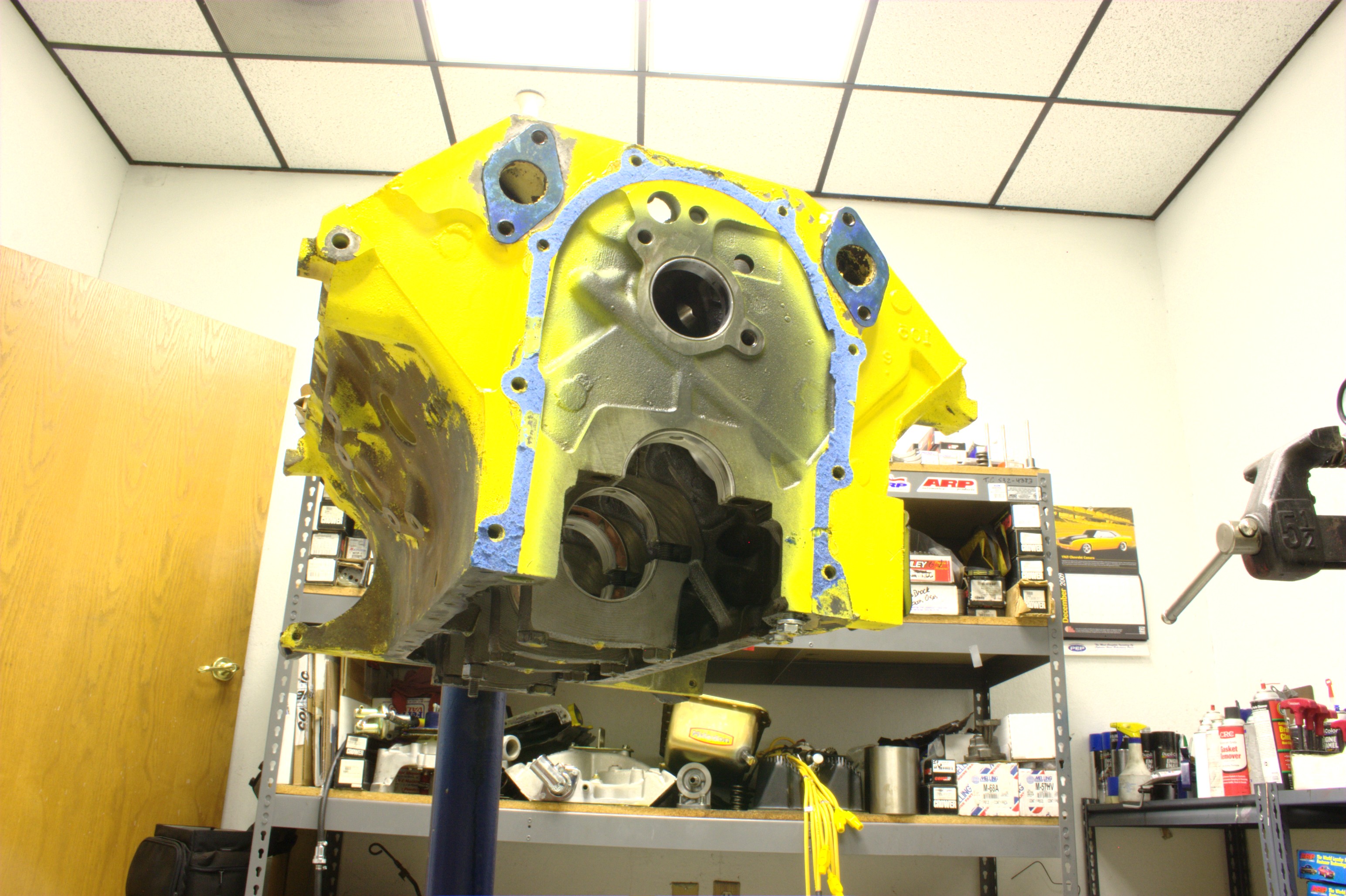

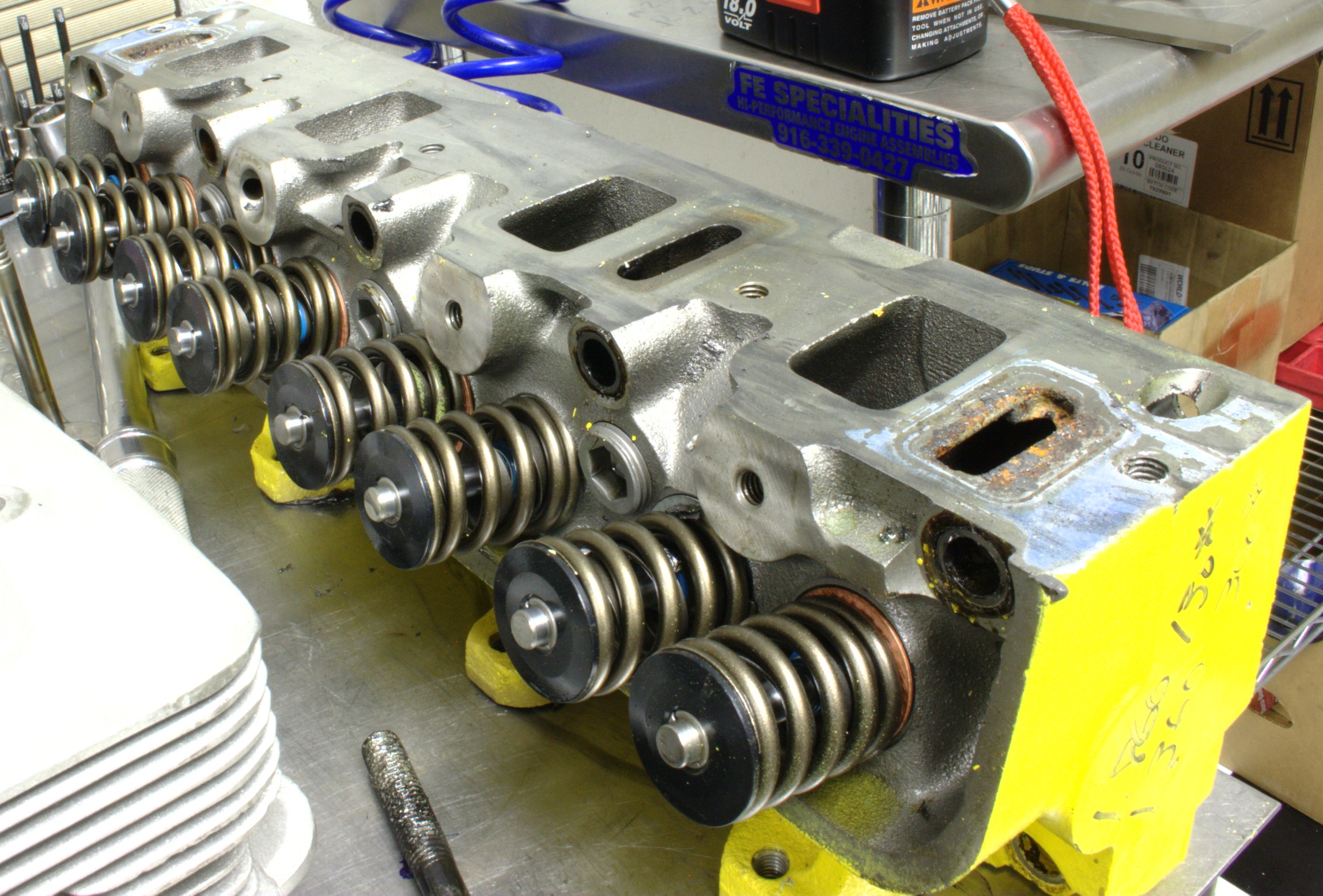

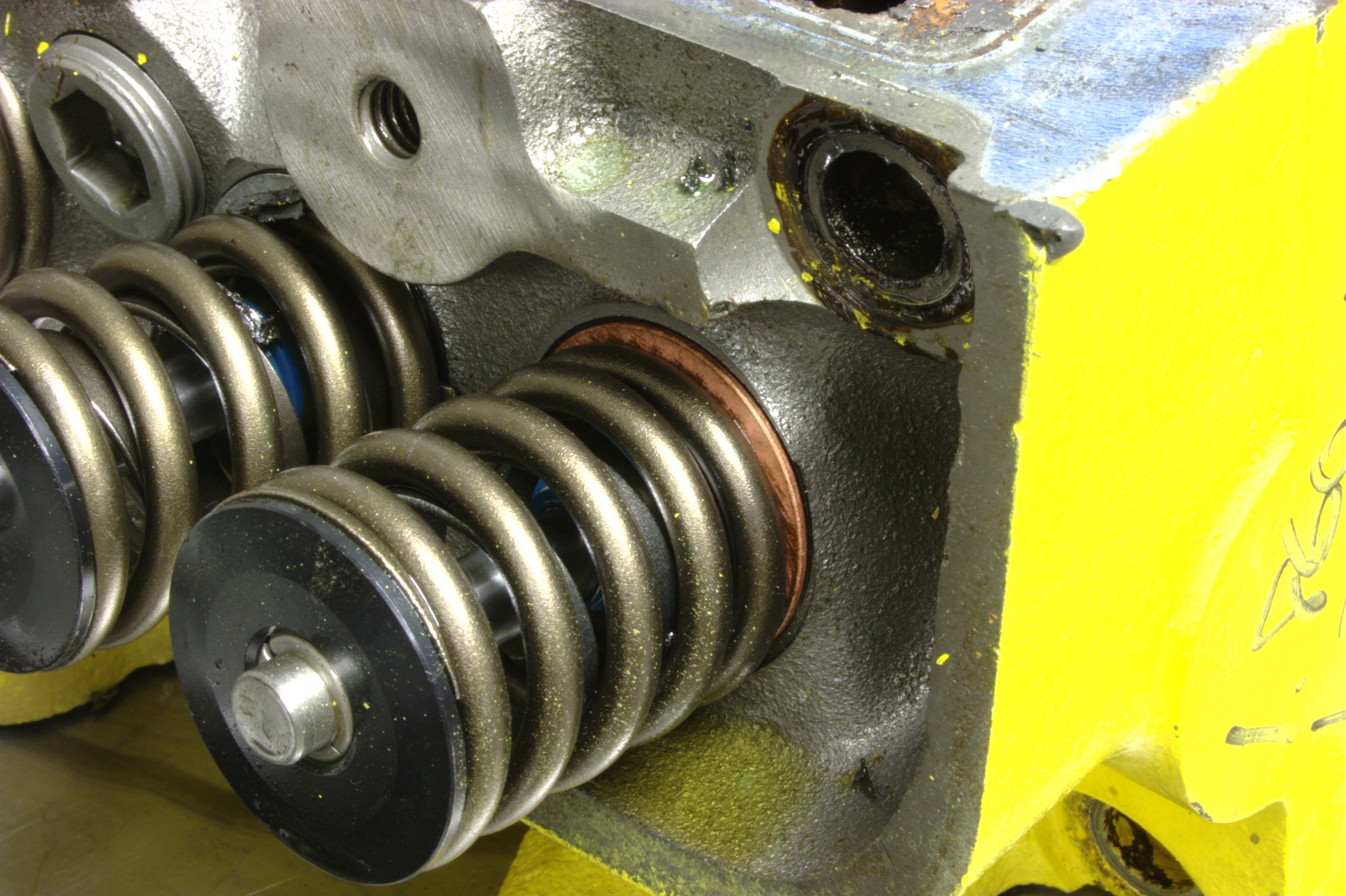

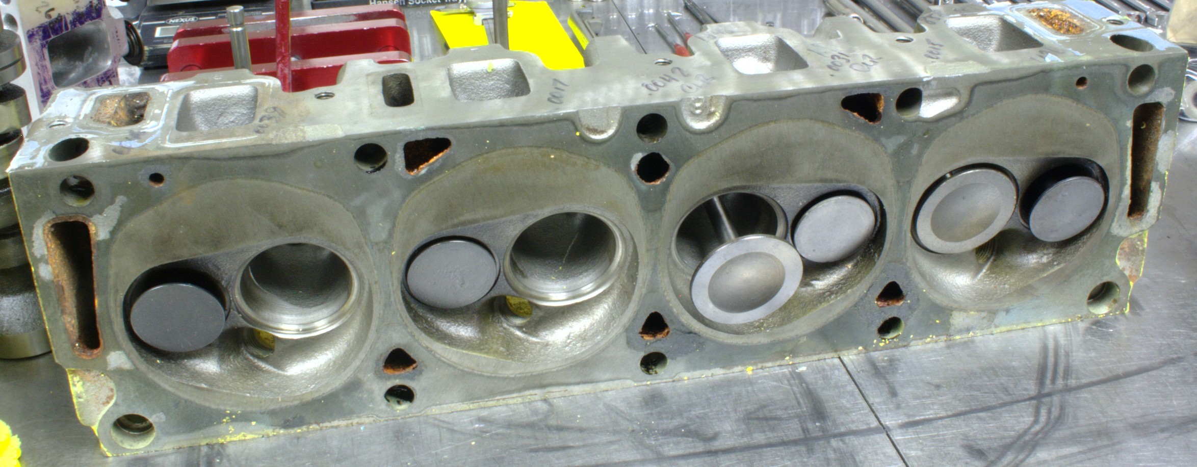

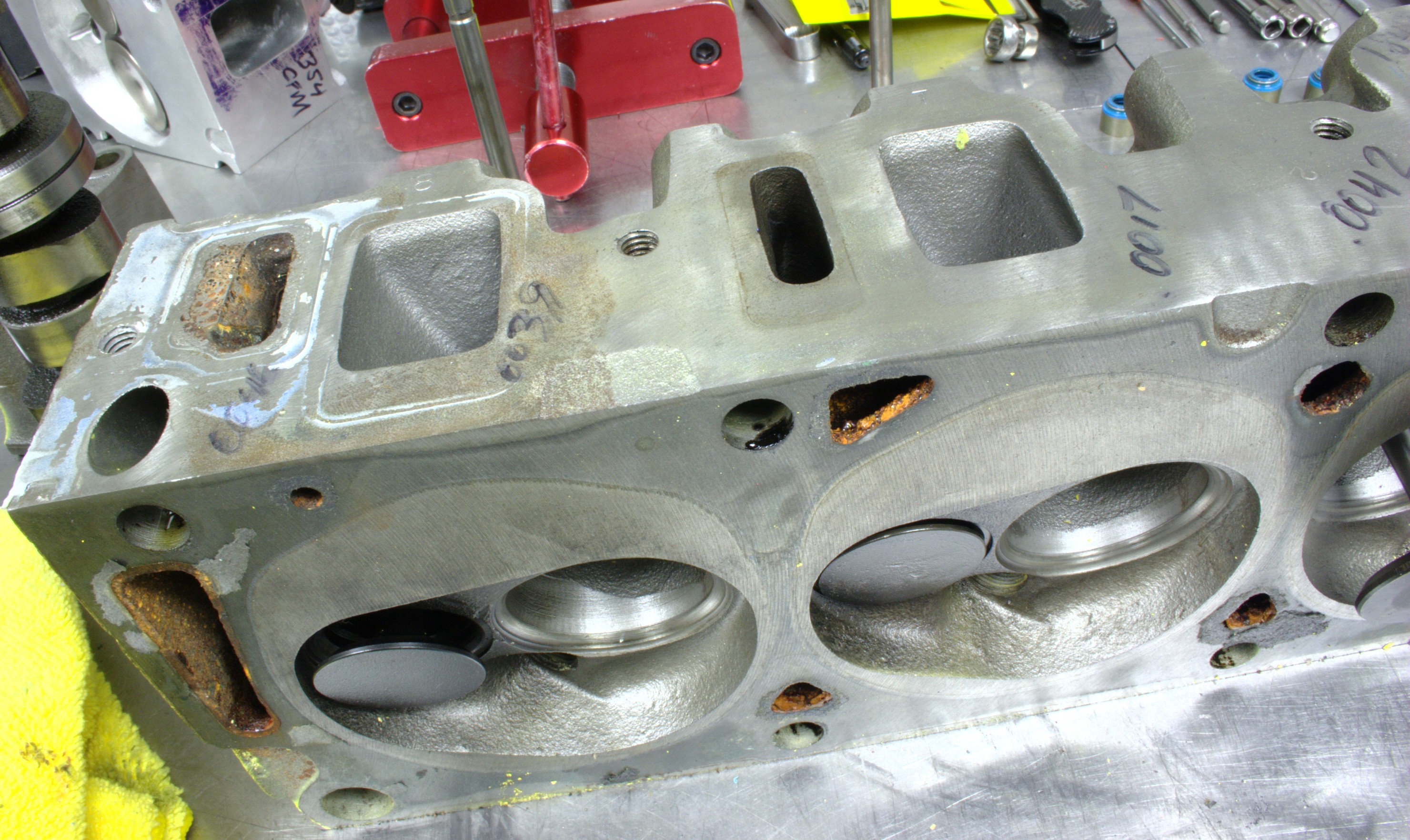

Here are a couple of photos of the front of the engine. The bearing on the right's the camshaft bearing, right? You can see how scratched up it is. Note that all these photos expand to much larger editions when they're clicked on.
A general shot of the front of the engine:

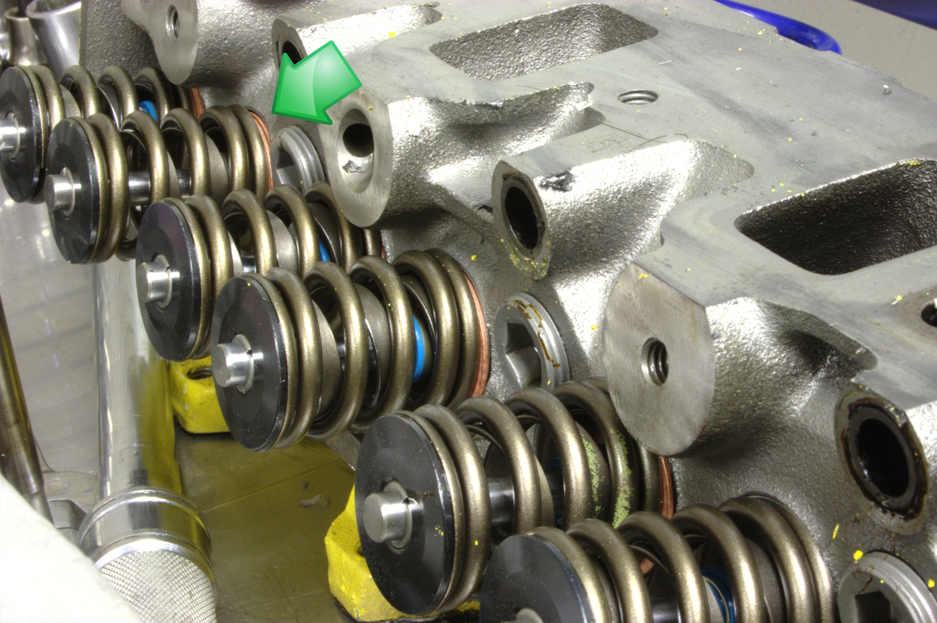

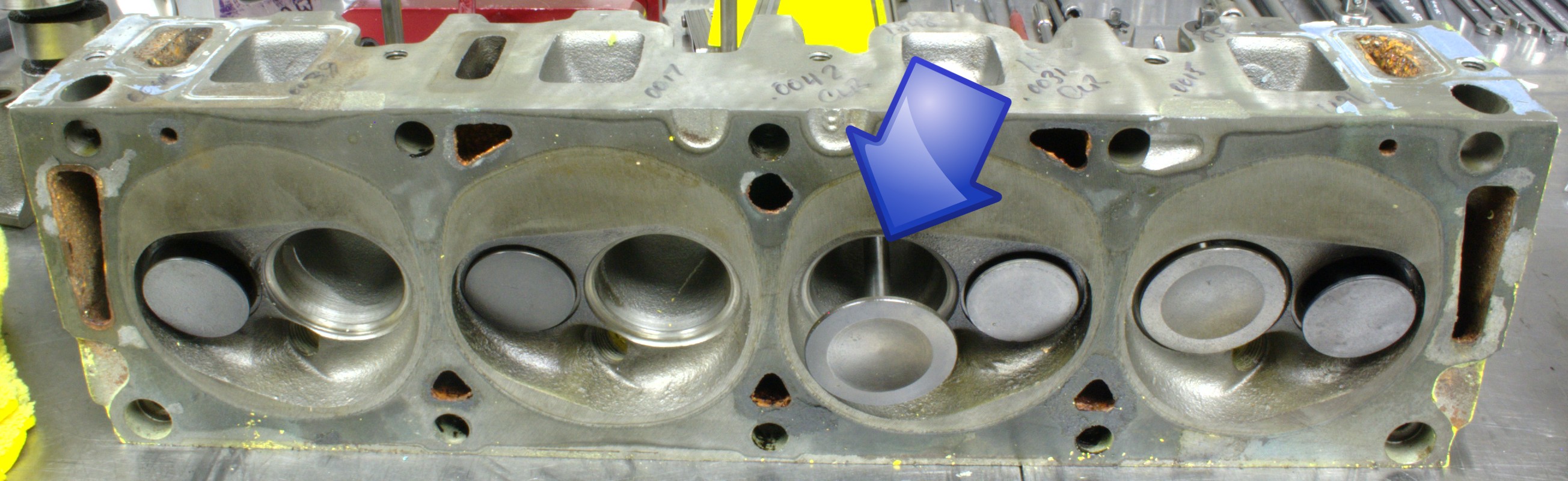

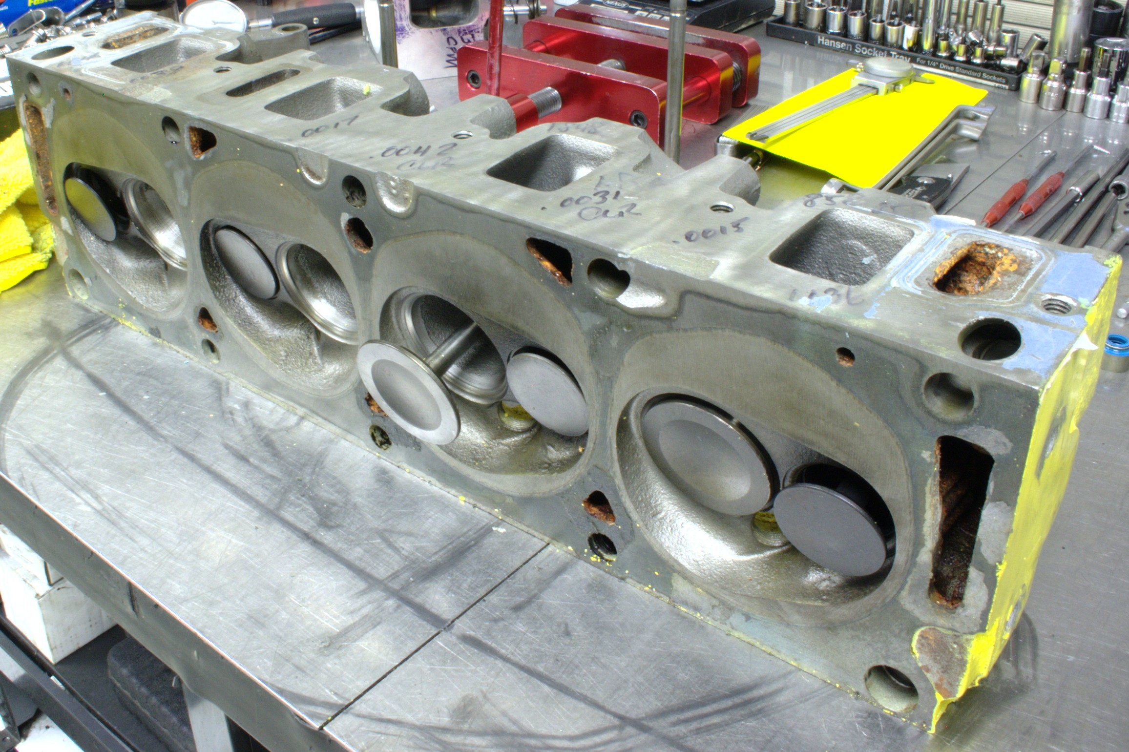

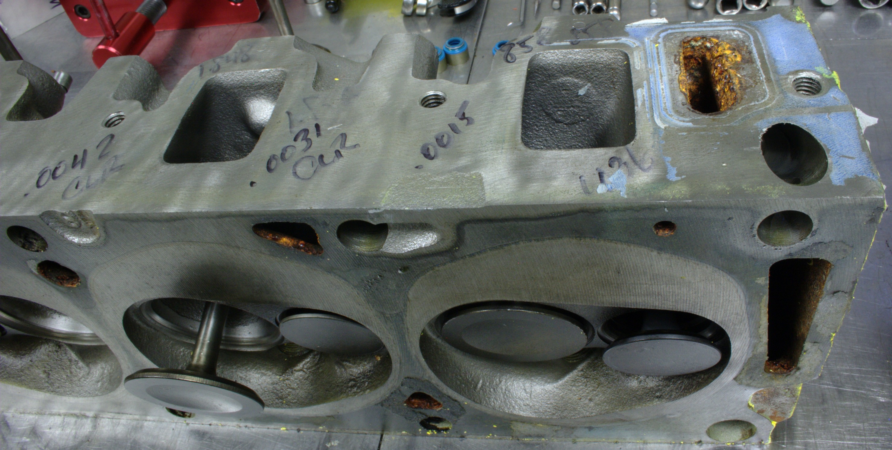

And now for the heads. I heard from Tom that the two huge problems with the engine were the camshaft coming apart, and the heads--the heads were in very bad condition.
Tom pointed out that the valve guides had been replaced, but their sizes weren't right! The clearance between the valve stems and guides varied dramatically. In this photo, the valve that's sticking out wobbled quite a bit in the guide--it wasn't tight at all!
In addition to the guide issue, some of the valve seats were significantly recessed (it was different on every valve). You can see some writing with a black marker above each cylinder area--those are Tom's notes on measurements. I forget exactly which thing those numbers represent (the play in the valve guides or the height of the seats). I think it was the seat heights but I forget.
Here are some more detailed, up close photos:
I heard from Tom that this head (and presumably the other also, although he only took apart one so far) was extremely sloppy, and the head problems would have caused the engine to fall apart very quickly, even if the camshaft hadn't failed. He said with those super loose valve guides, lots of oil would have started to get through the there and the engine would have smoked terribly and come apart after a small number of miles.
More photos as I process them!

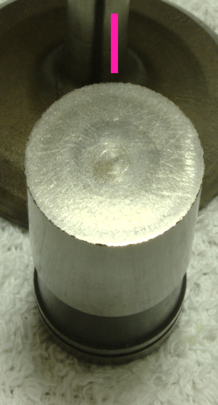

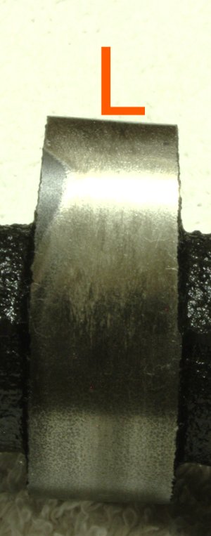

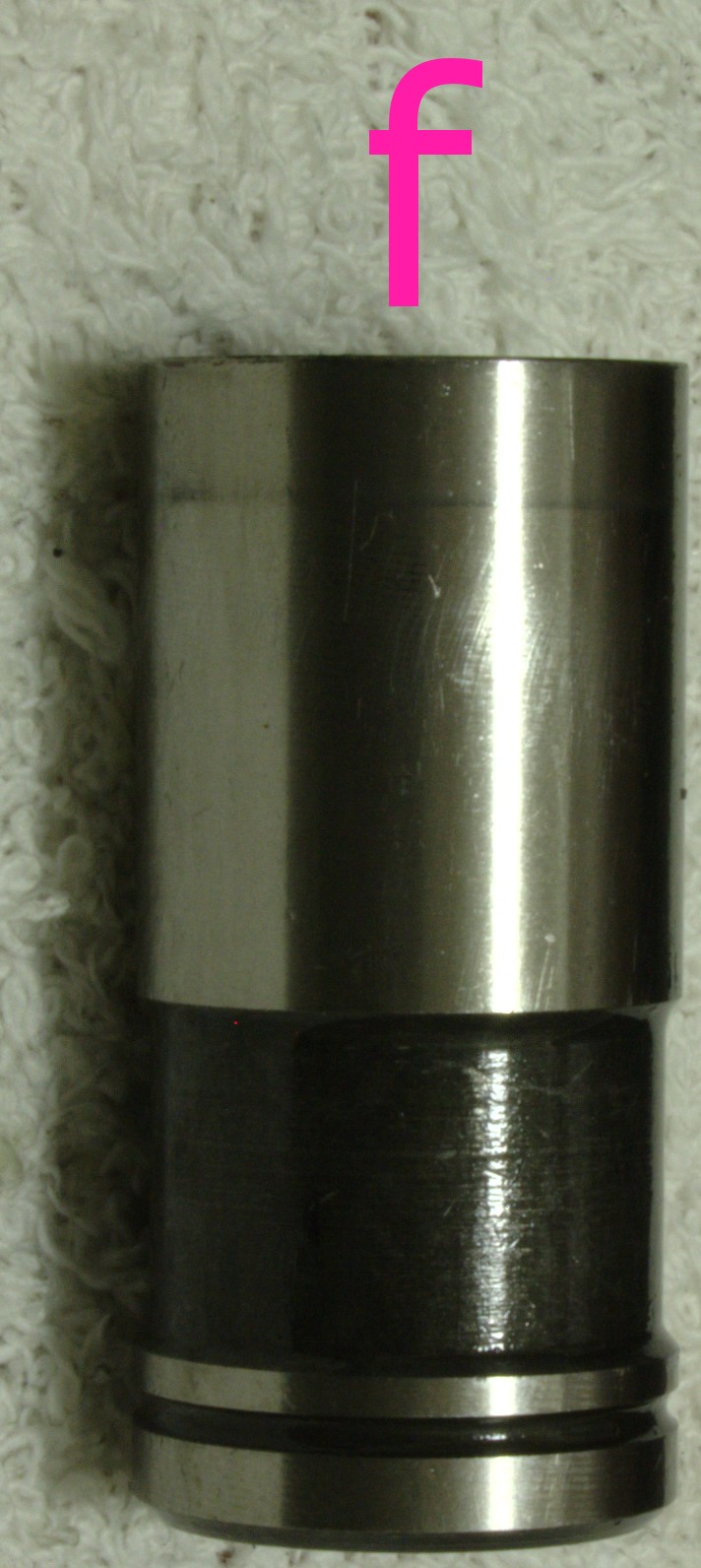

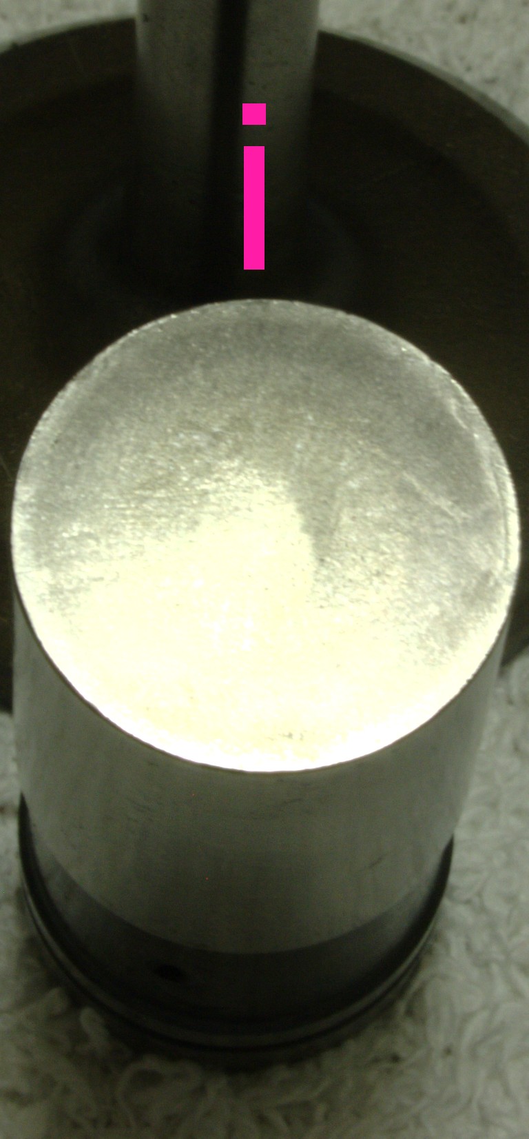

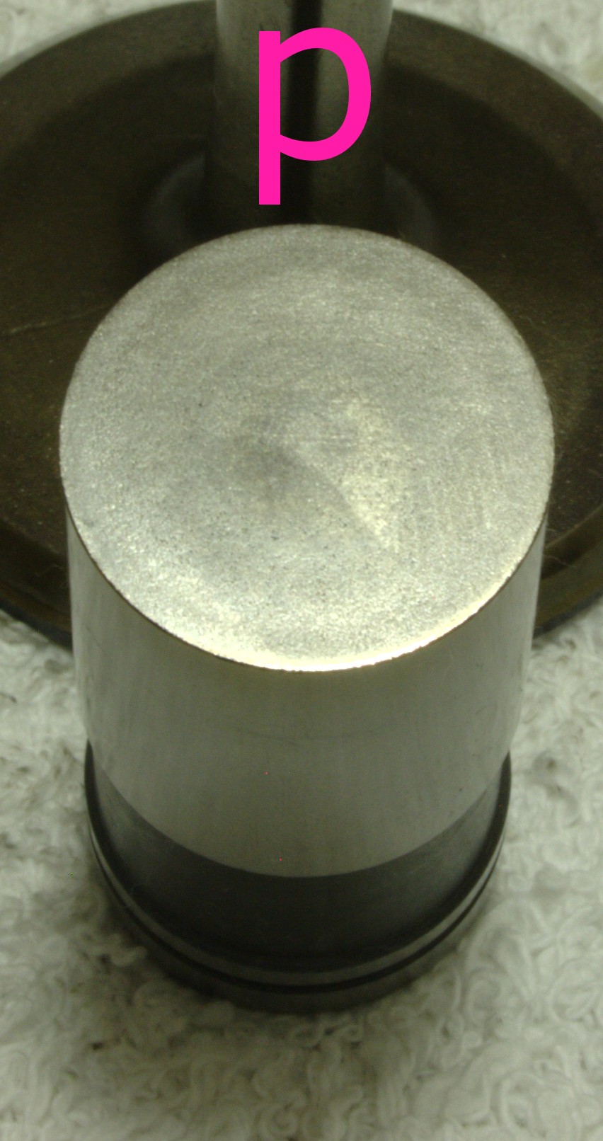

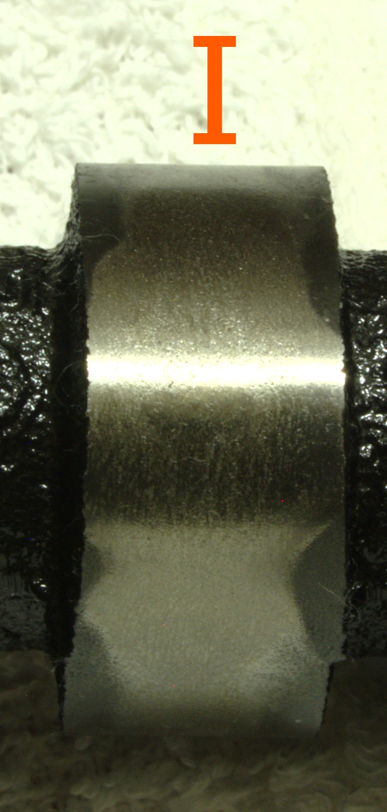

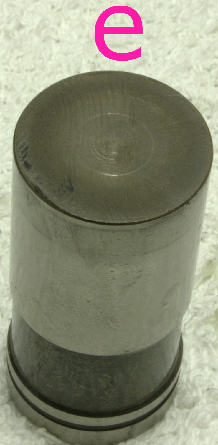

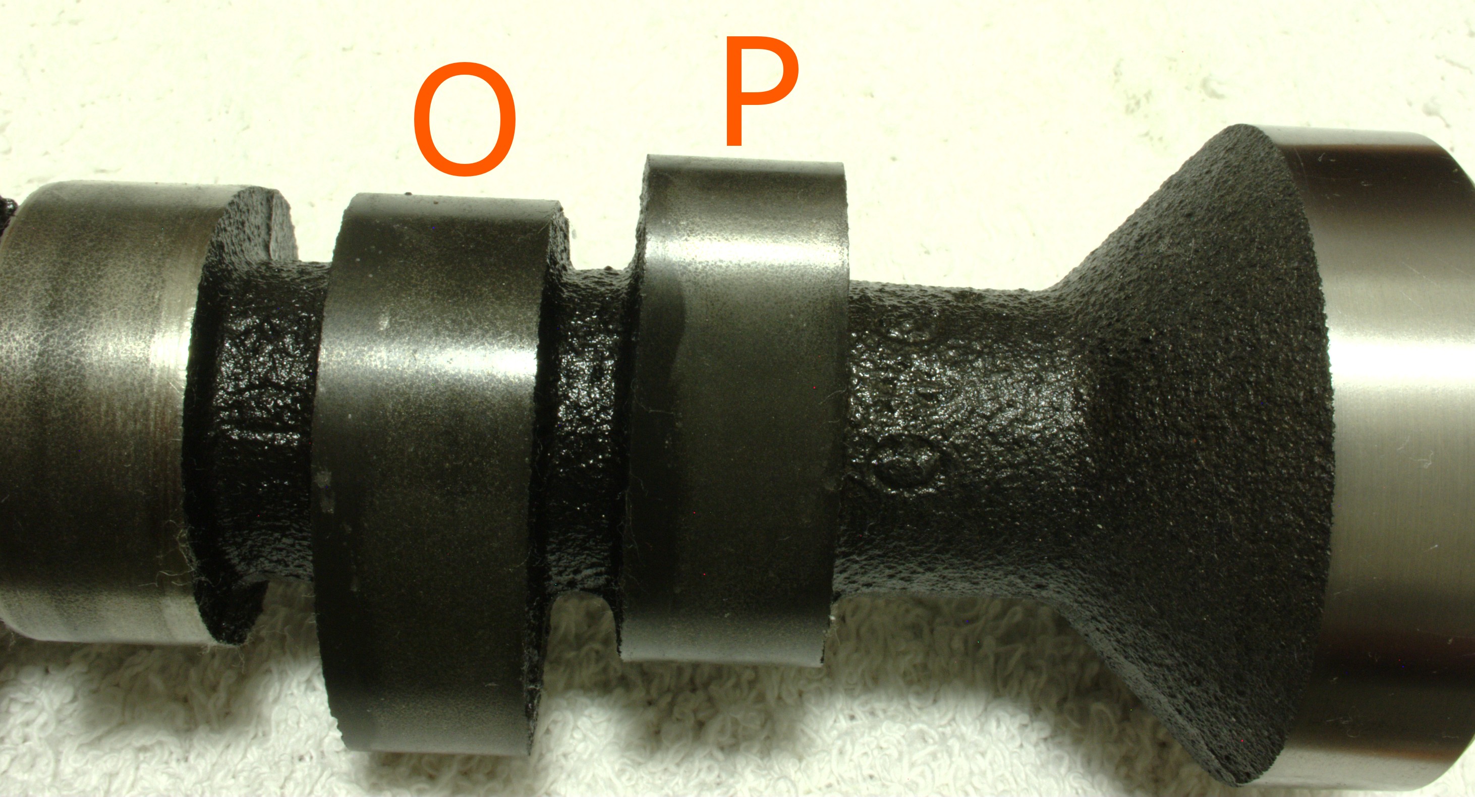

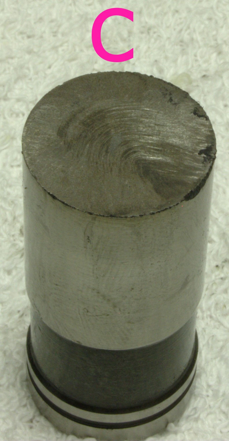

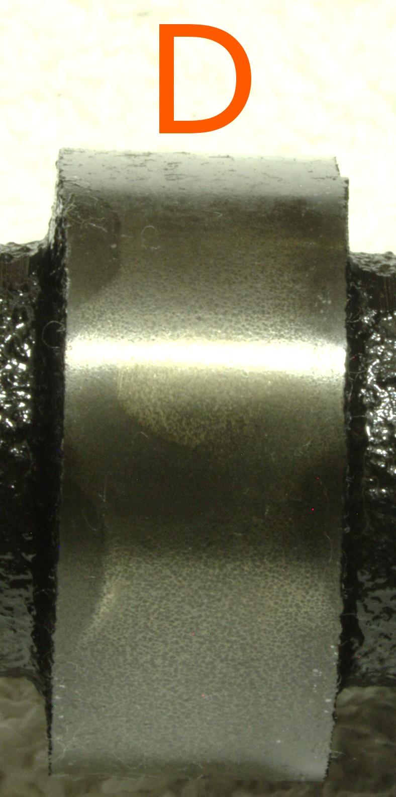

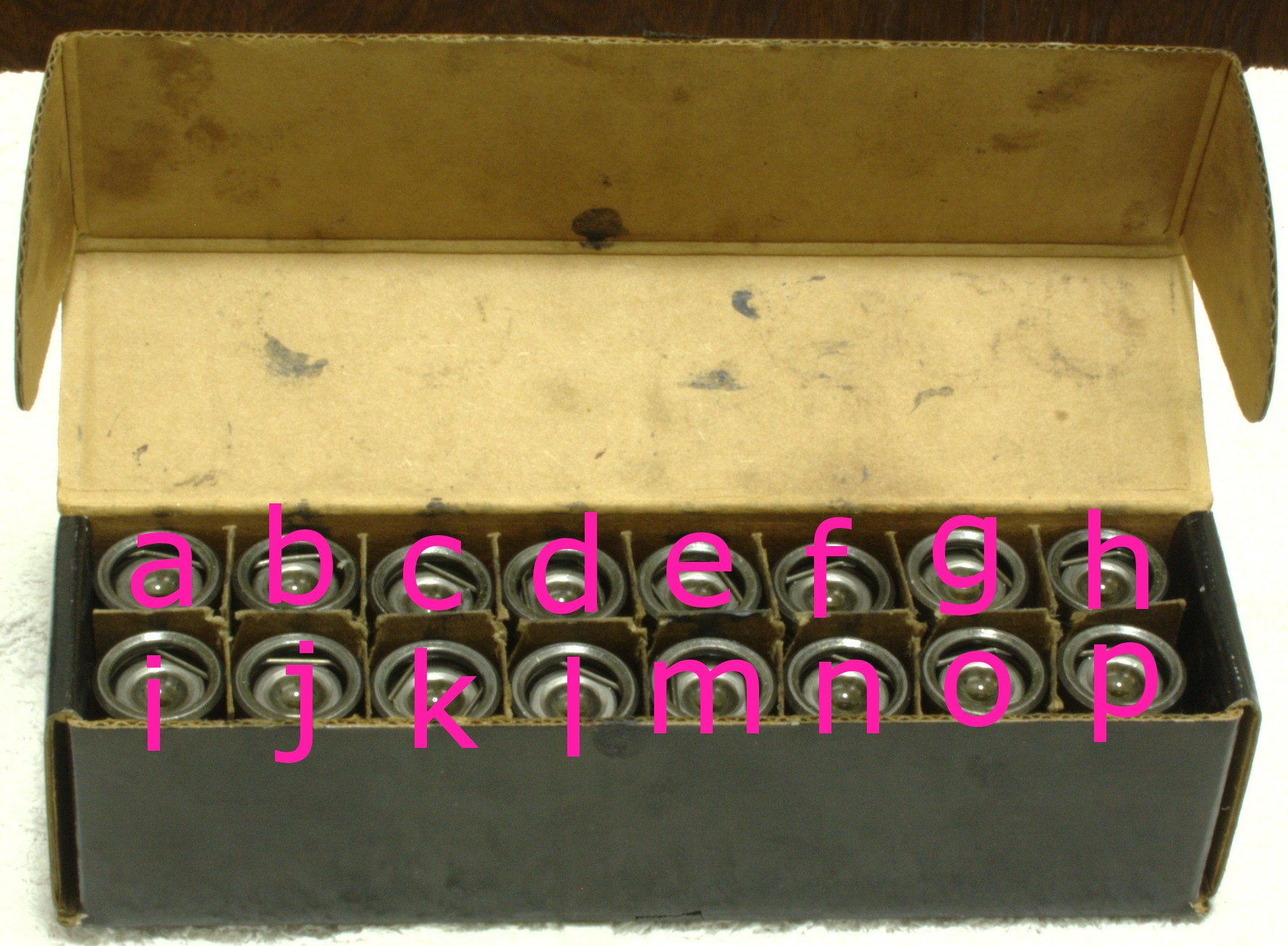

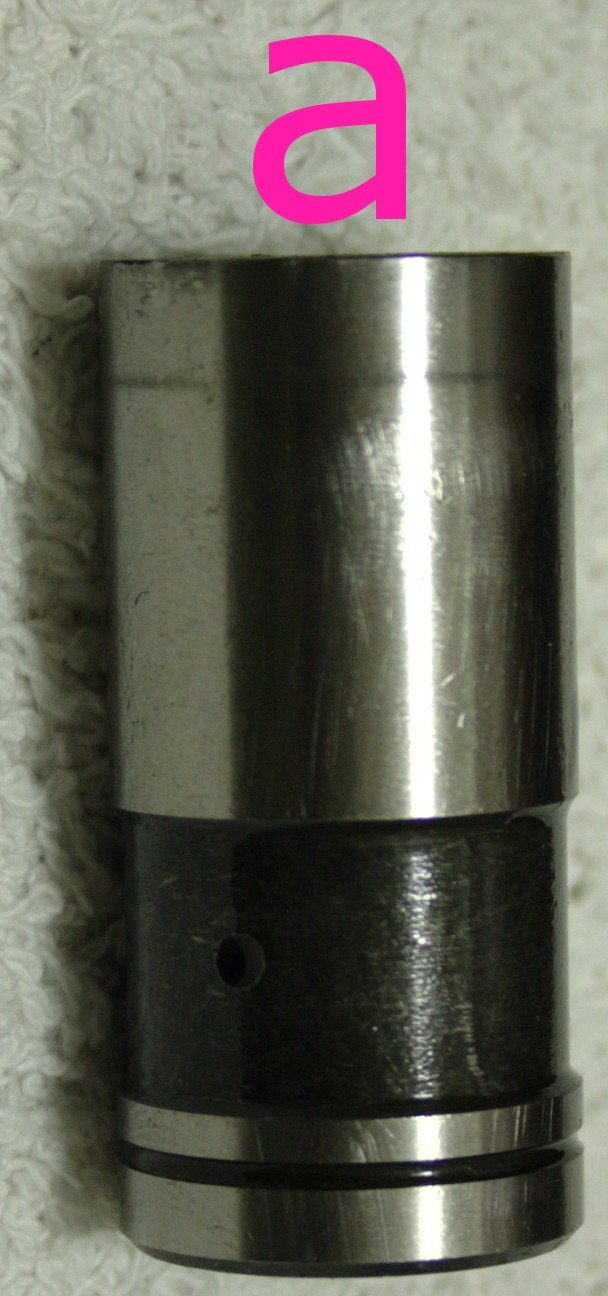

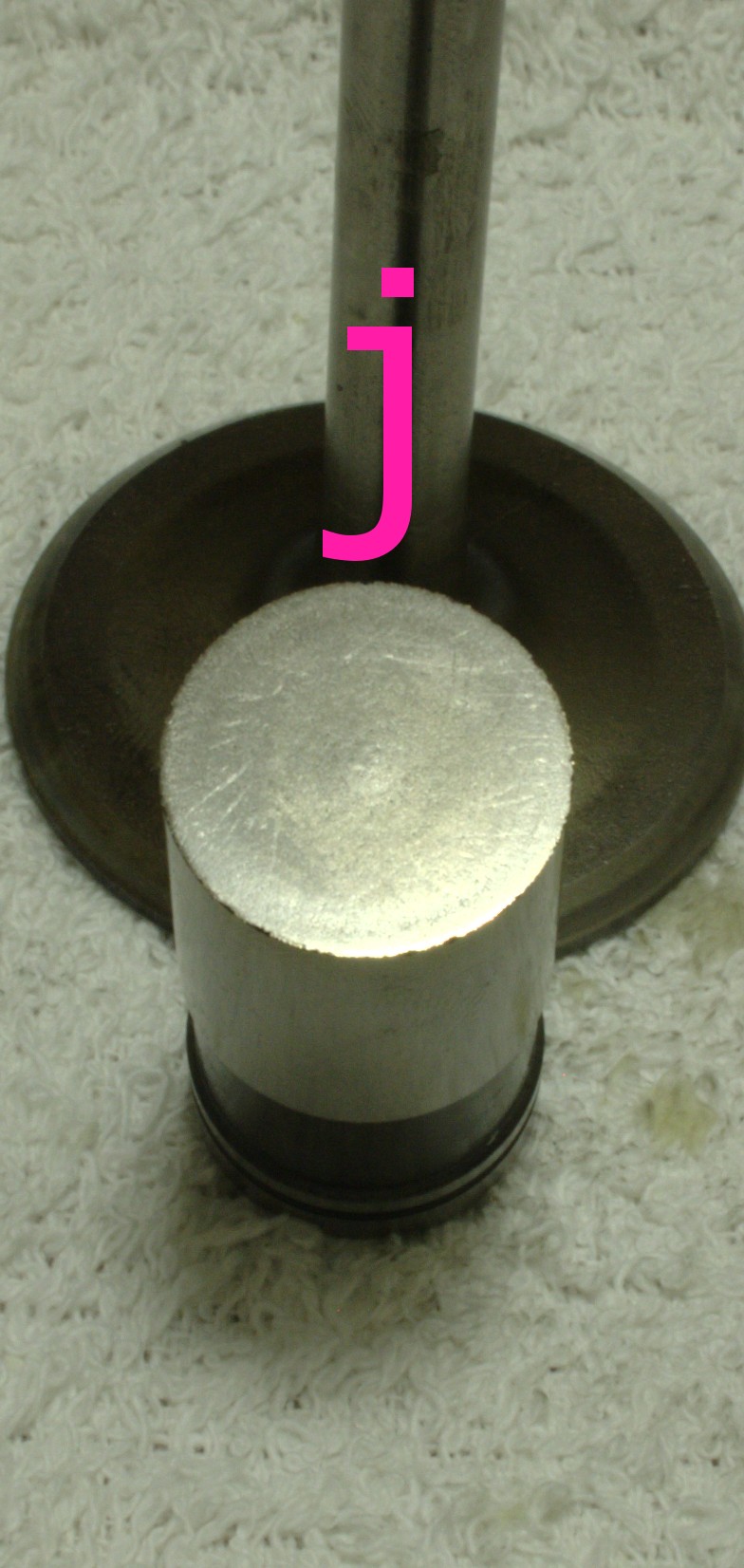

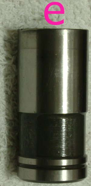

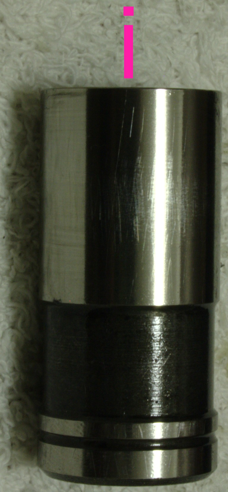

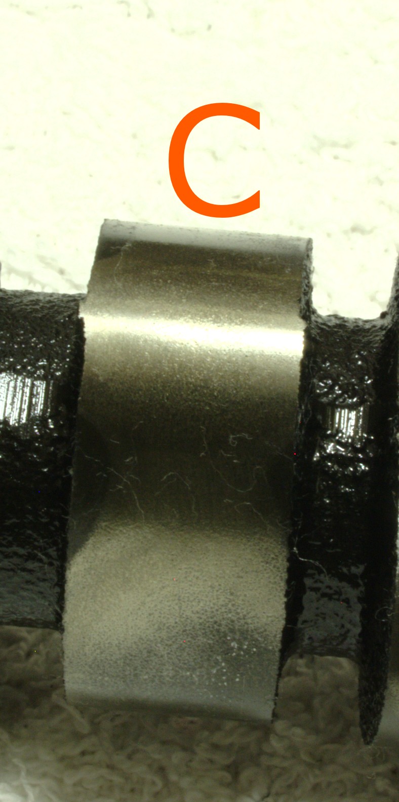

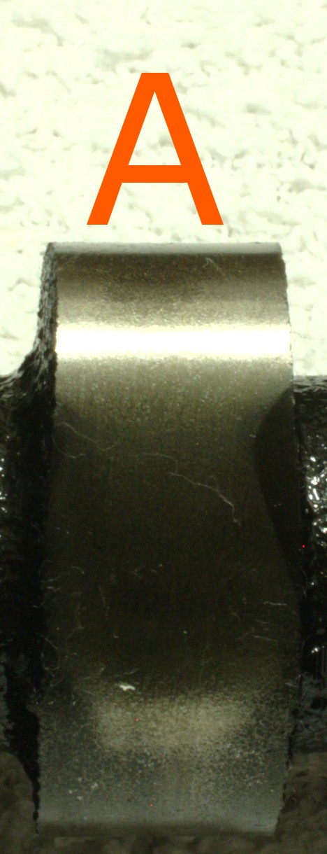

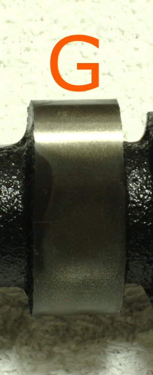

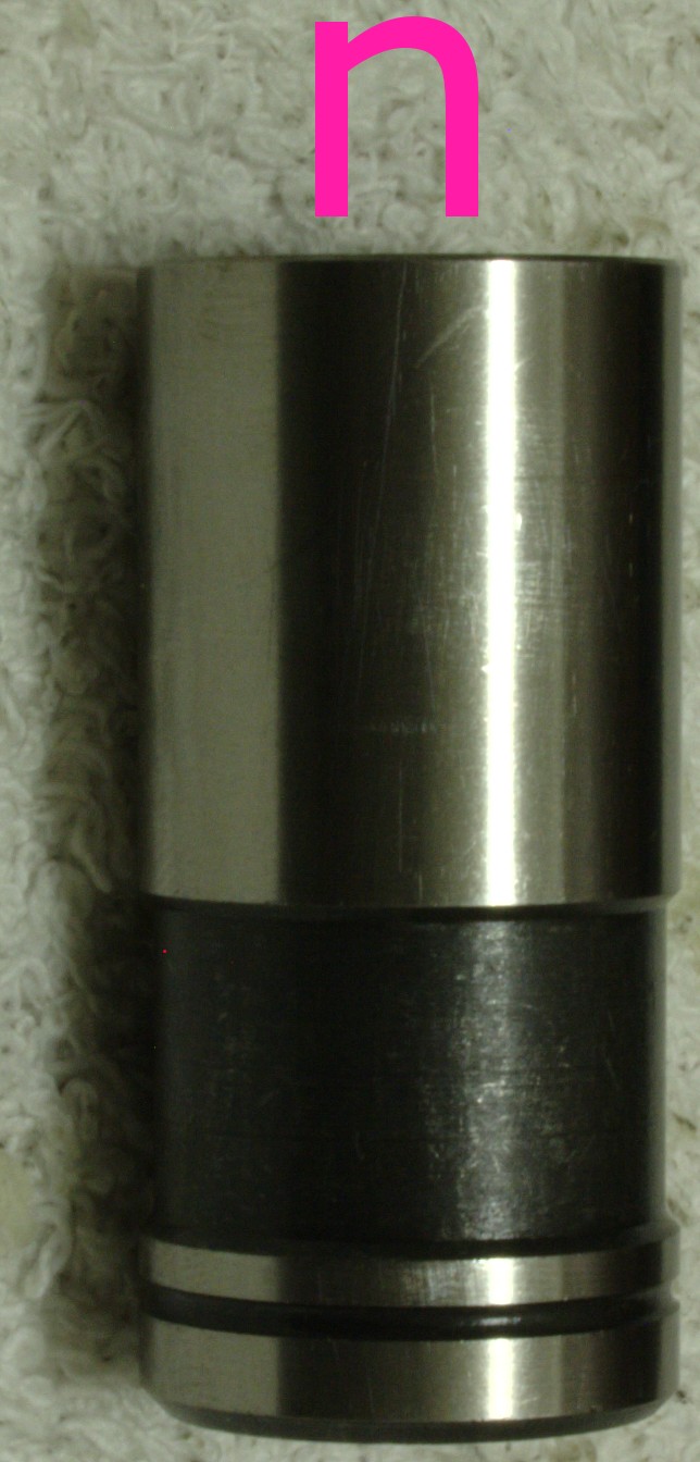

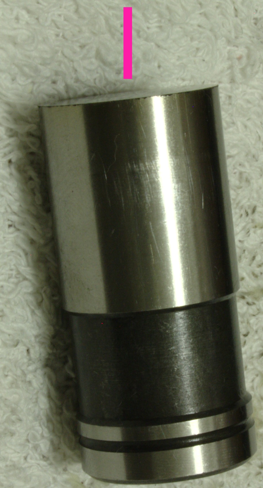

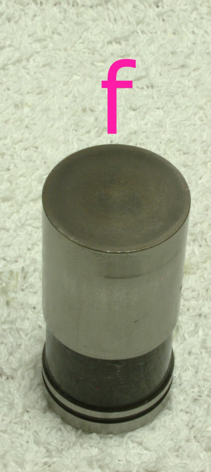

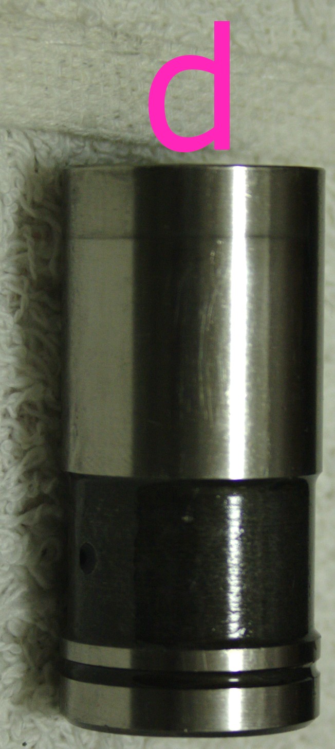

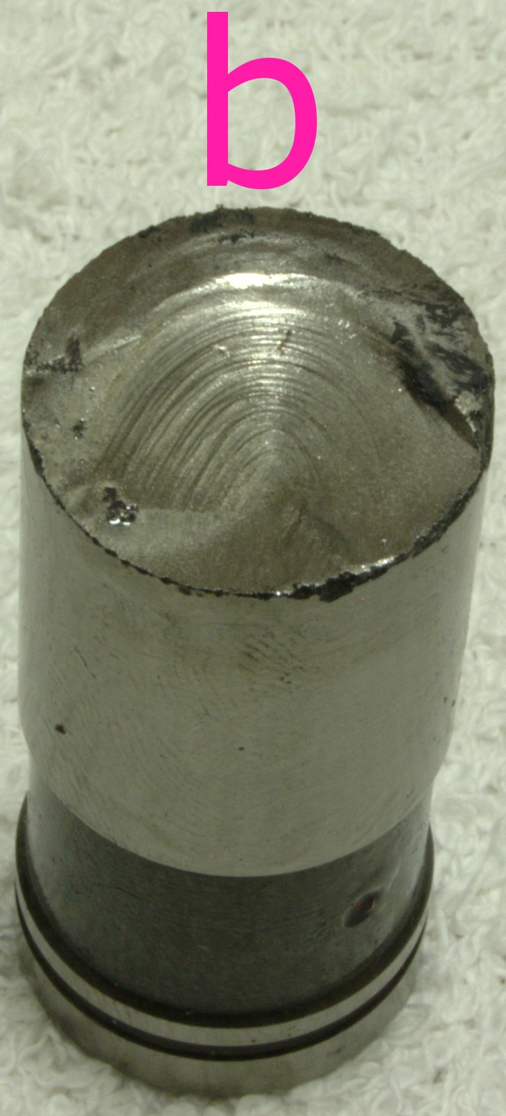

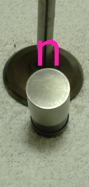

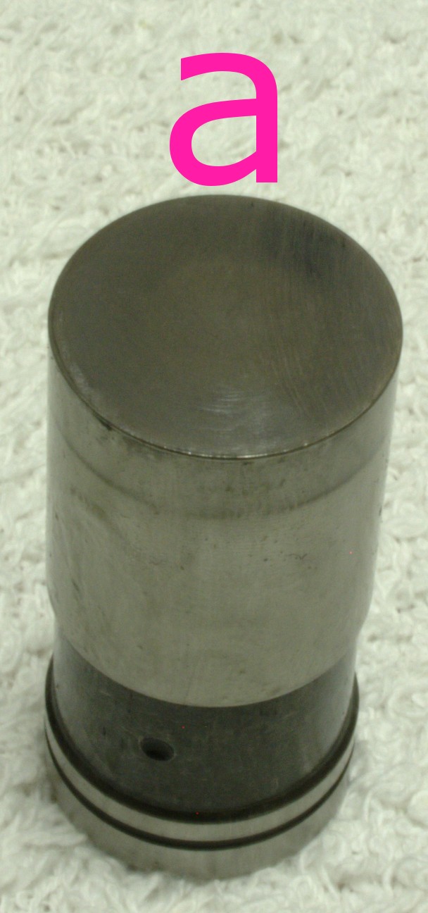

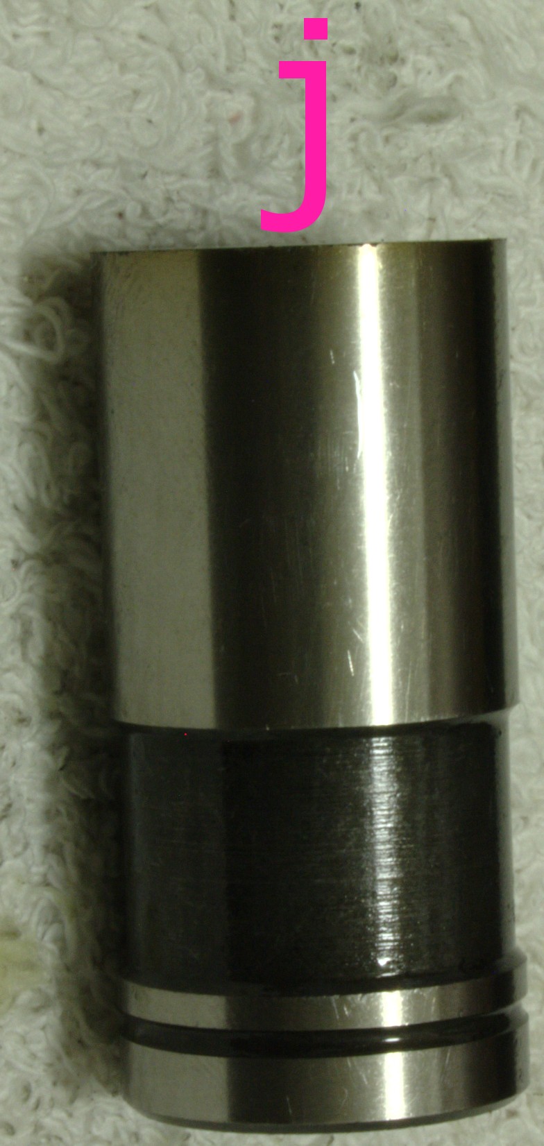

Ready for an insane level of detail here? Here are the valve lifters. I labeled them with letters corresponding to their positions in the box Tom gave me. I'm willing to bet that Tom habitually places lifters in a box in a certain order, so he'd know which lifter went to which cylinder and valve. If this information becomes of interest, I can ask him for that information and post a legend for my photos.
As always, these tiny photos lead to huge, high definition ones when they're clicked on (I can stop saying this right?). :)
Lifter "a" seems to be in decent shape.

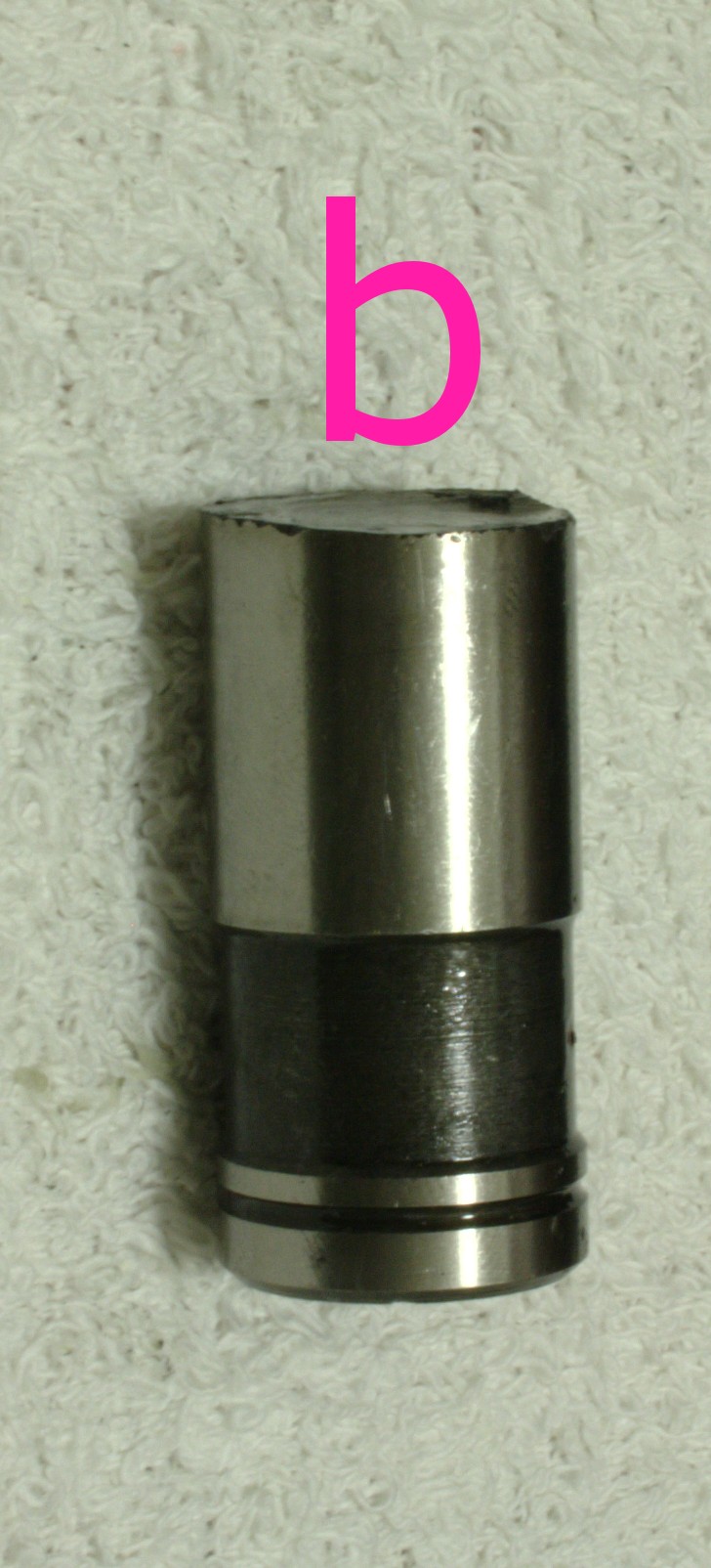

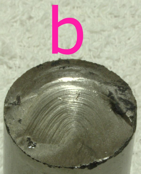

But WOW, what happened to lifter "b?" My gosh.
Here's a close-up of lifter "b's" head. Ouch!

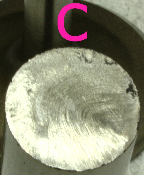

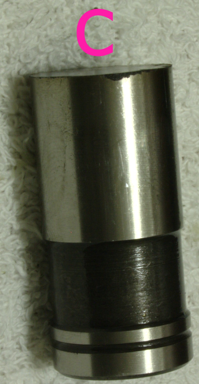

Lifter "c" is not happy, but didn't run in to Freddy Kruger like "b" did. Note that the edge around the top of lifter "c" is pretty sharp and jagged, with little chips missing.
Here's another close-up of "c." This exposure didn't turn out too well, but it shows the hard core wear pattern from a different angle.

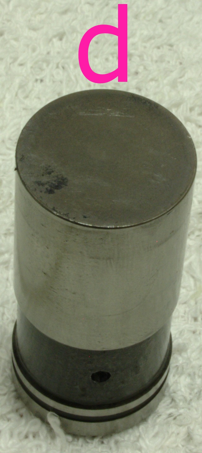

Lifter "d" looks reasonably healthy.

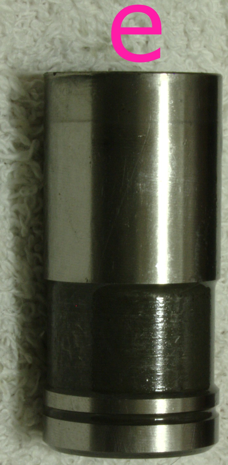

Lifter "e" seems OK, but the surface around the top edge is a little rough in one spot. I think you can kind of see it.
Lifter "f" looks OK, I guess.

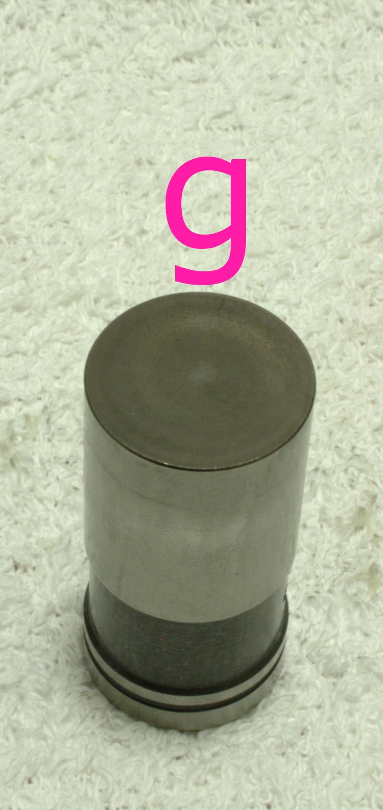

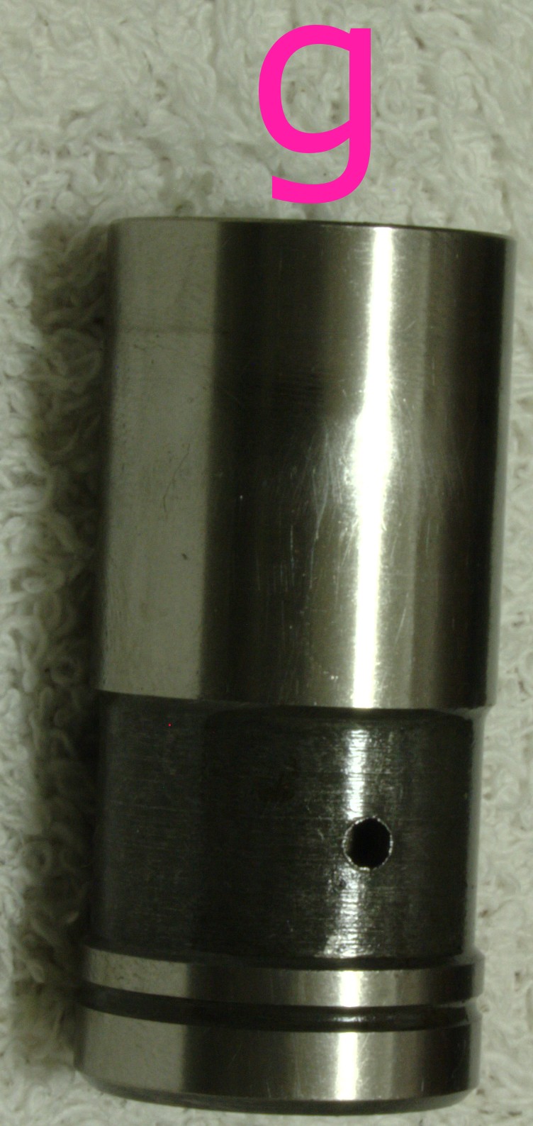

Lifter "g" looked OK also.

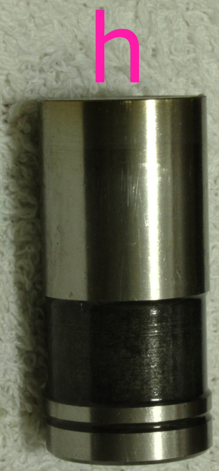

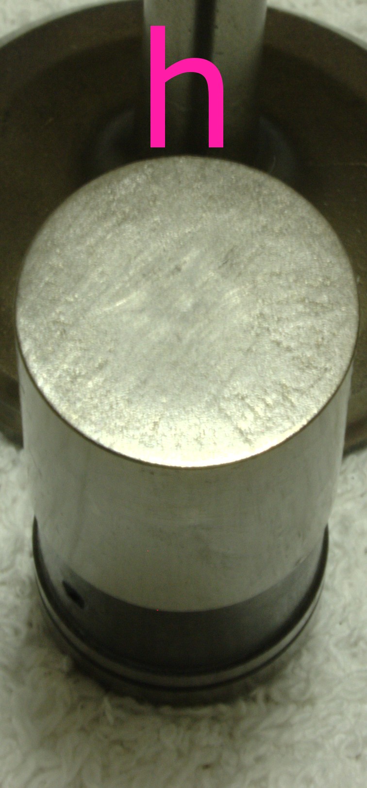

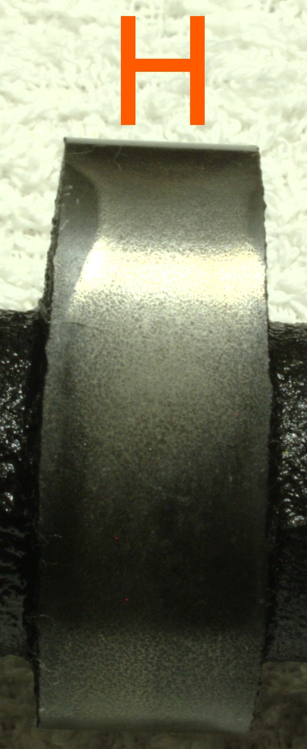

Lifter "h" wasn't very happy! The edge around the top has lots of little chips in it (it's now a sharp edge), and you can see where Woody Woodpecker has been working on the top surface. Oddly, the wear pattern is quite different here than on the other damaged lifters.
Lifter "i" looked OK, although you can see some light scratches on the side (maybe that's nothing important).

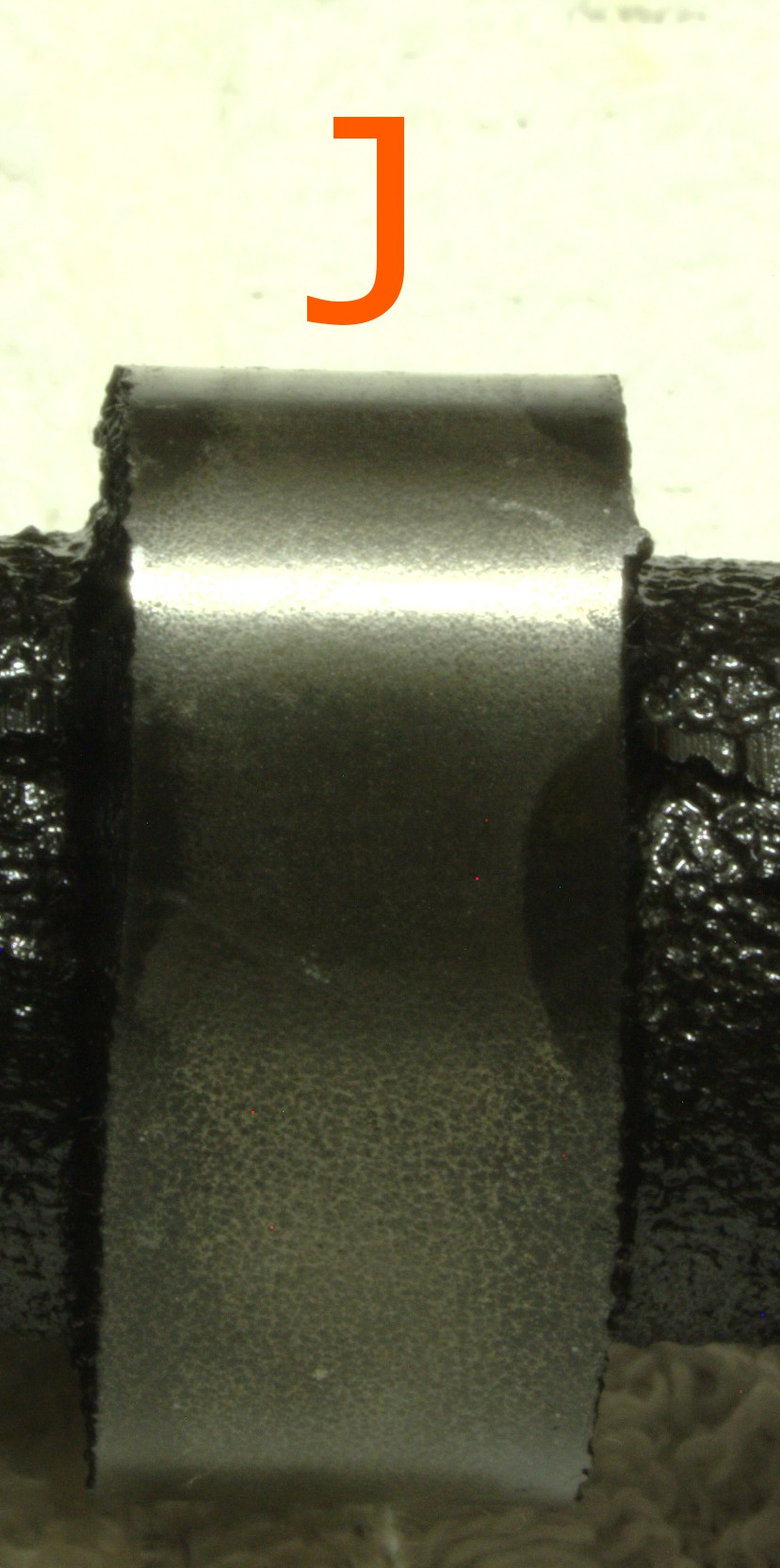

Lifter "j" wasn't in hot shape. The upper edge was pitted and rough, and you can see a funny wear pattern on its head.

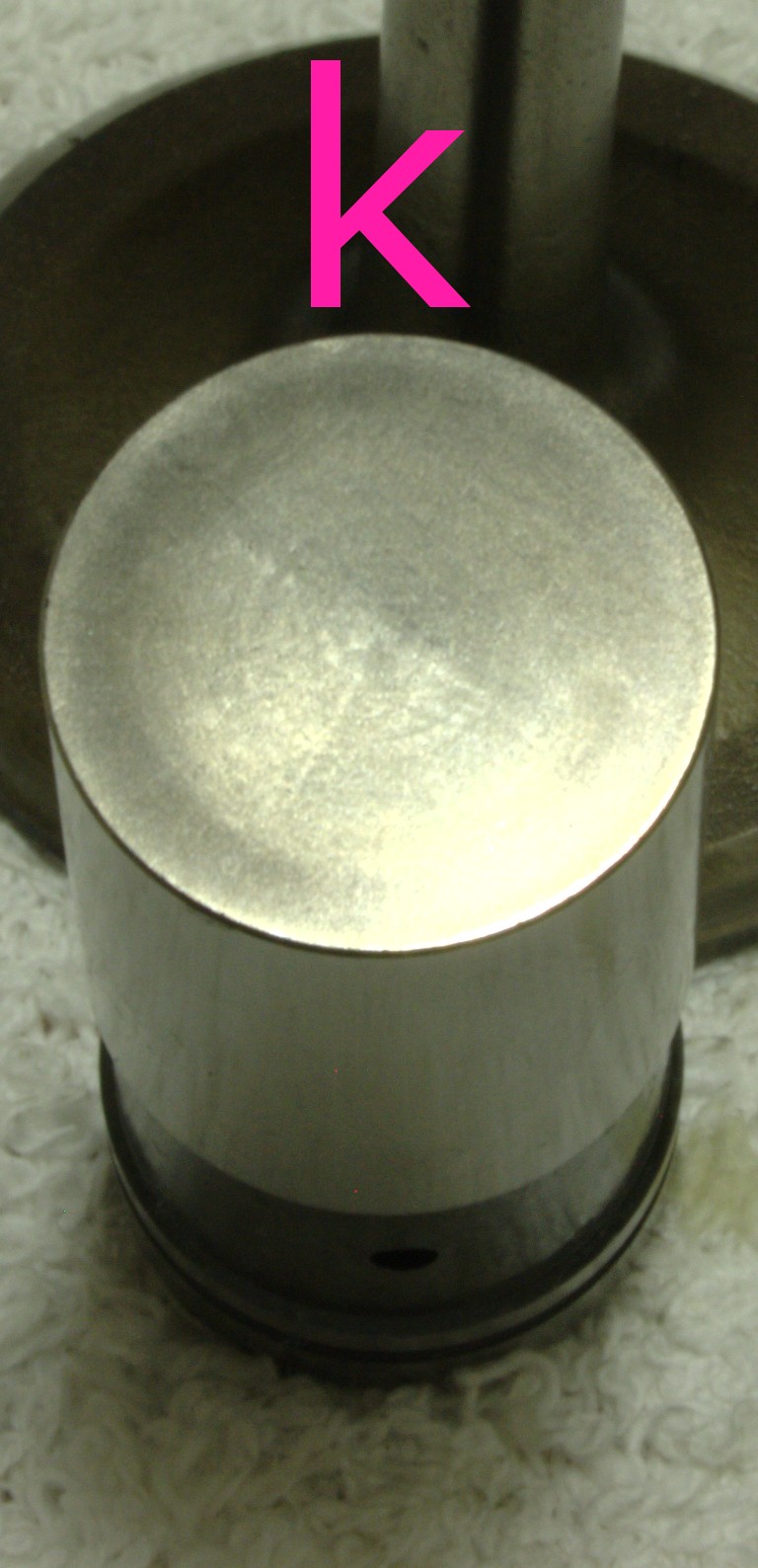

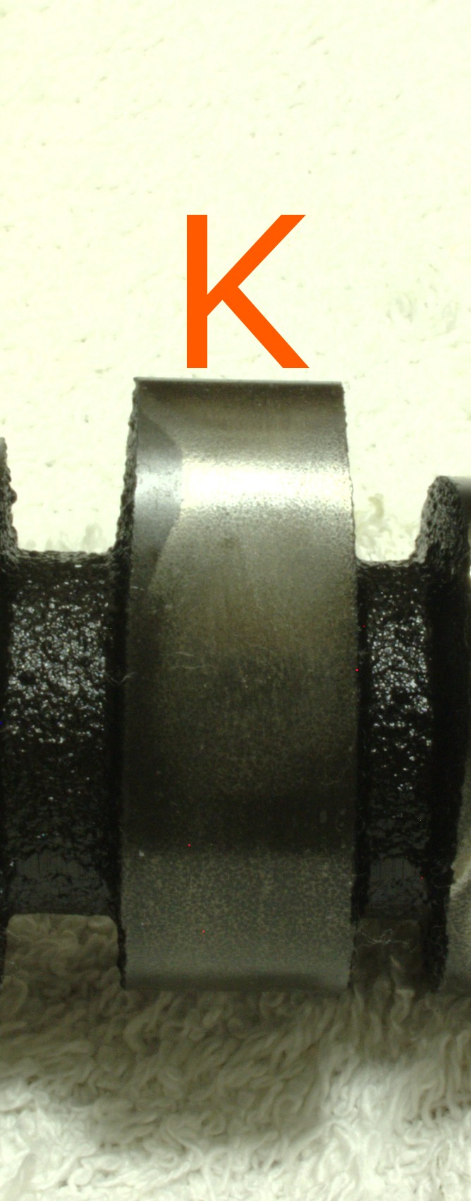

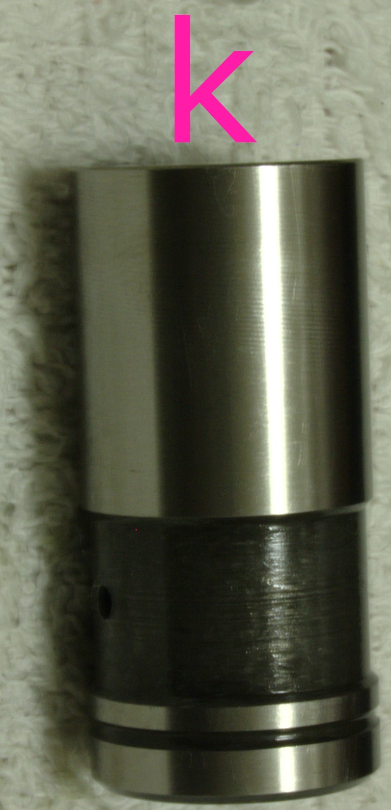

Lifter "k" seemed OK.

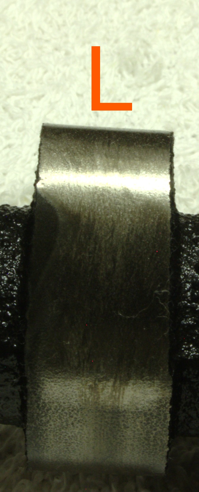

Lifter "l" was pretty messed up. You can see the rough, chipped upper corner surface, and the top has the chicken-scratch wear pattern going on.

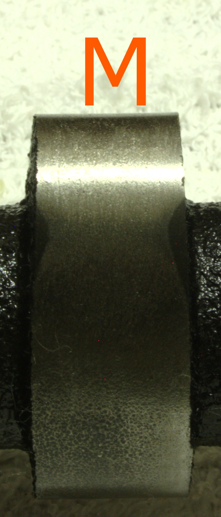

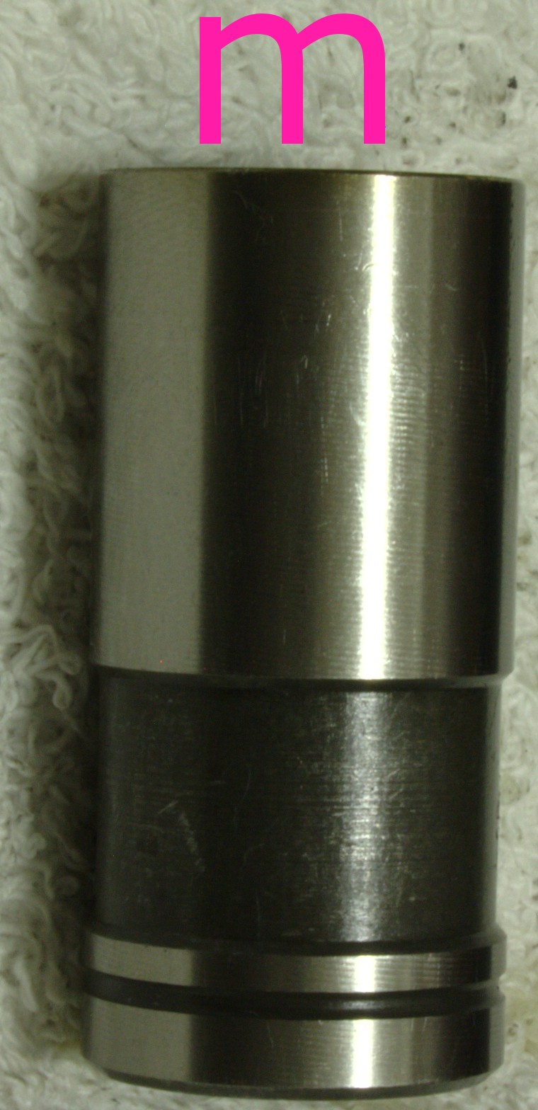

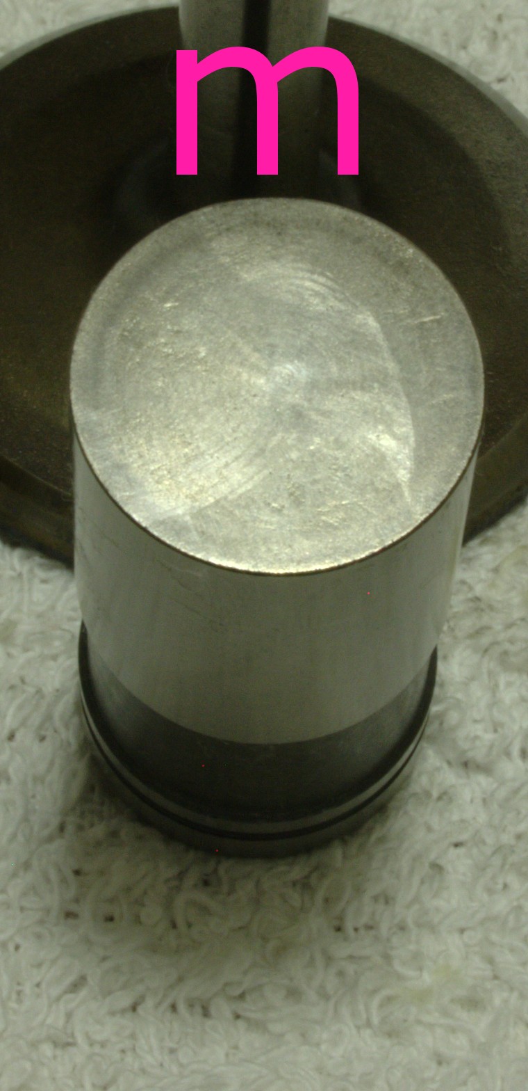

Lifter "m" was only slightly hurt. Its surface does have some chicken scratches on it, although the upper edge is pretty smooth.

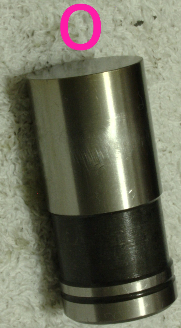

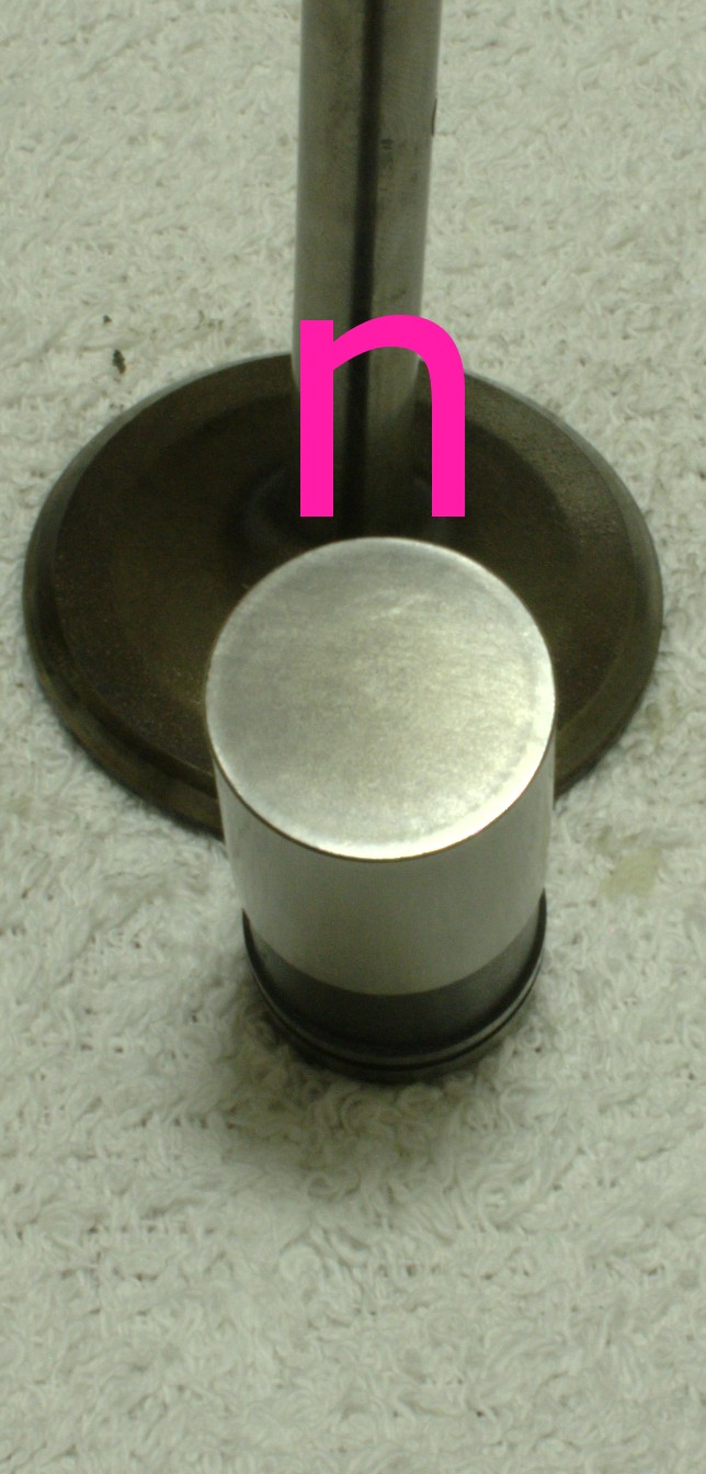

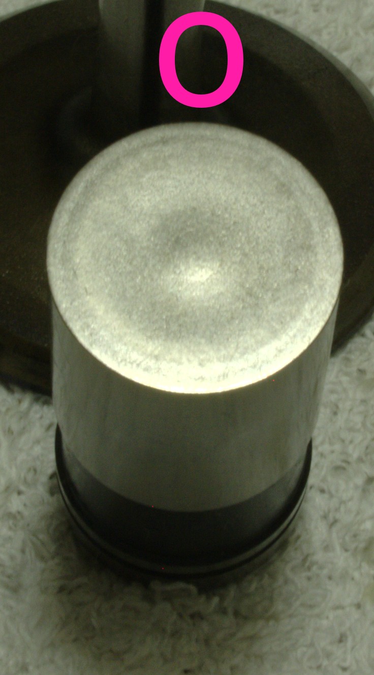

Lifter "n" looked OK.
The upper edge on lifter "o" was pretty chipped up and rough. Its top surface also has some light wear marks. It looks OK in the photos, so maybe these are things that you'd have to feel by hand.

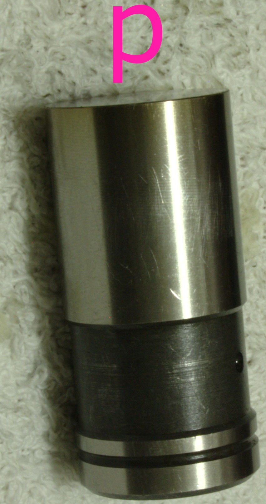

Lifter "p" also had a pitted, sharp upper edge, although its top surface looked OK.
You can see how lifter "b," "c," and a few others came apart! Are any of you still wondering where all the metal came from in my oil? Just wait until you see the camshaft (coming soon)!

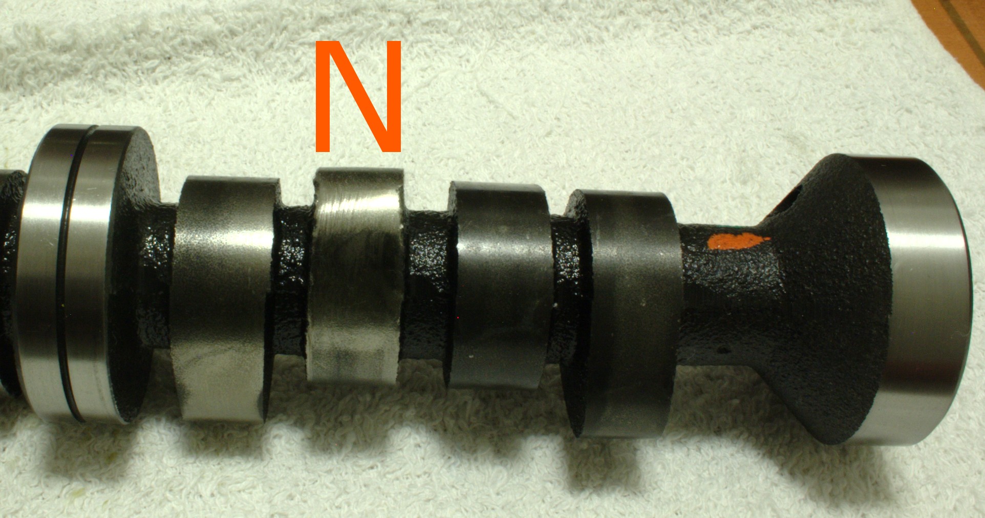

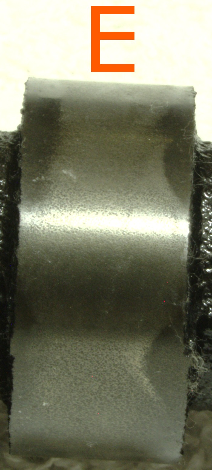

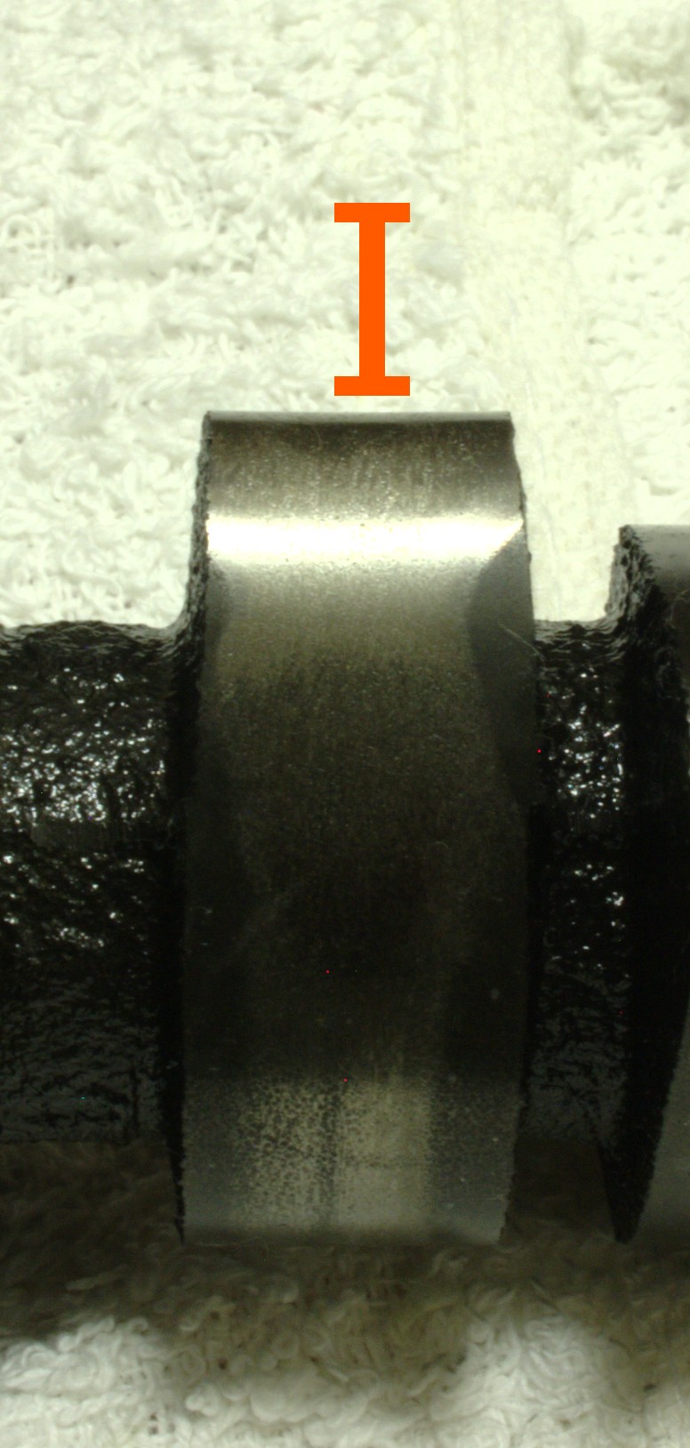

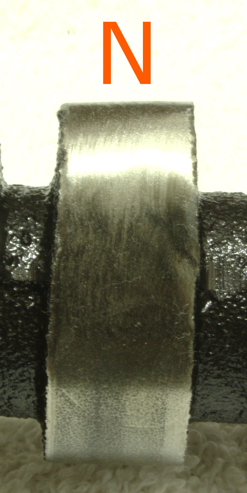

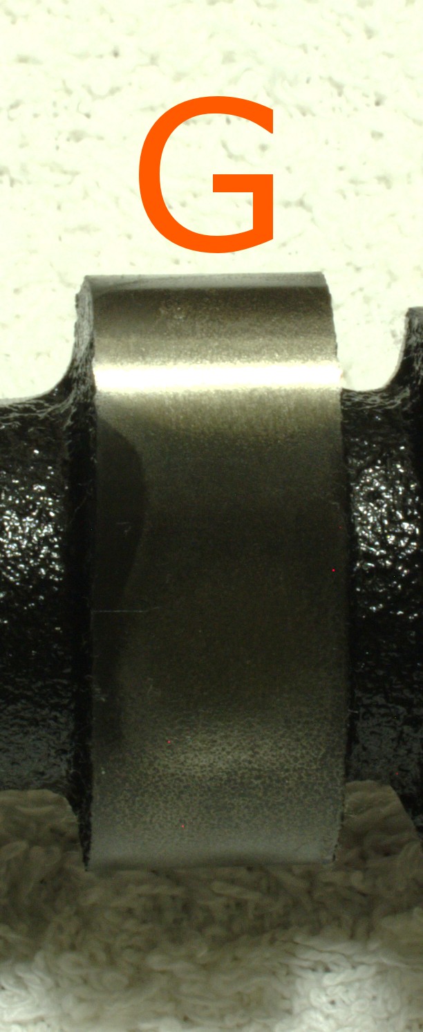

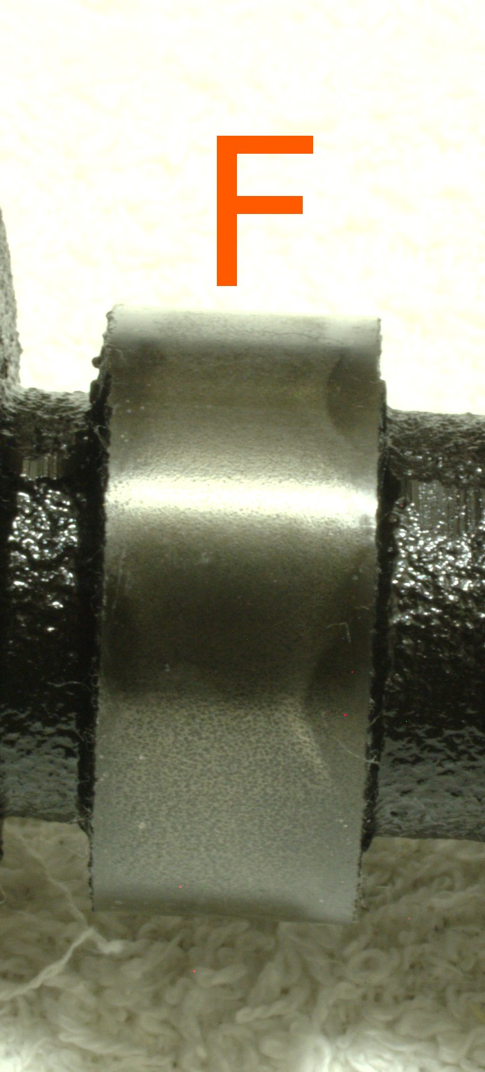

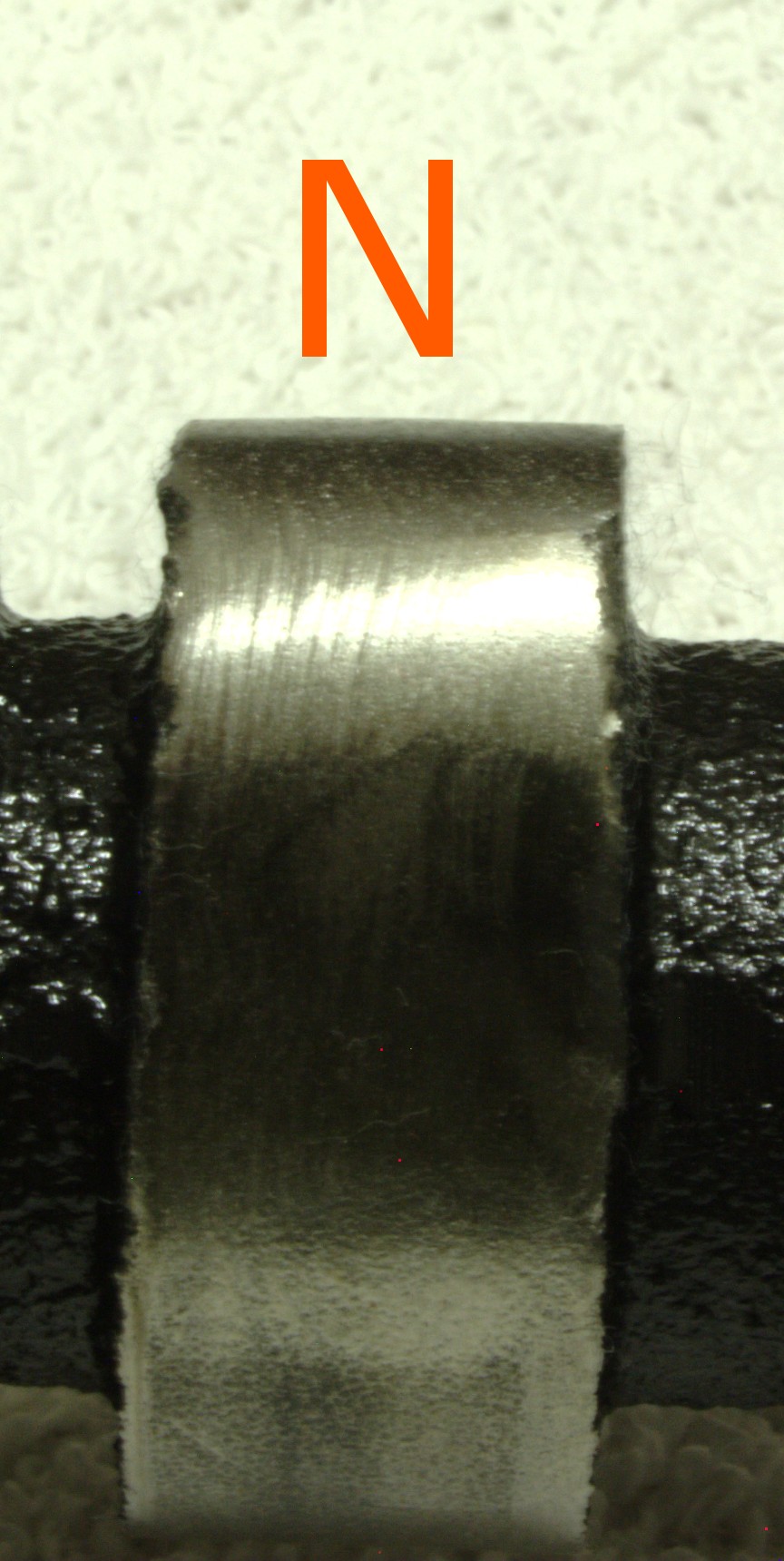

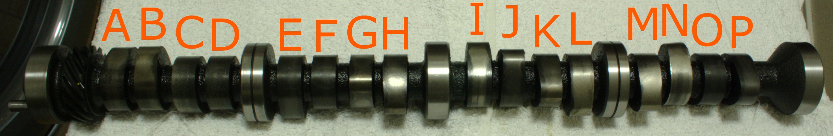

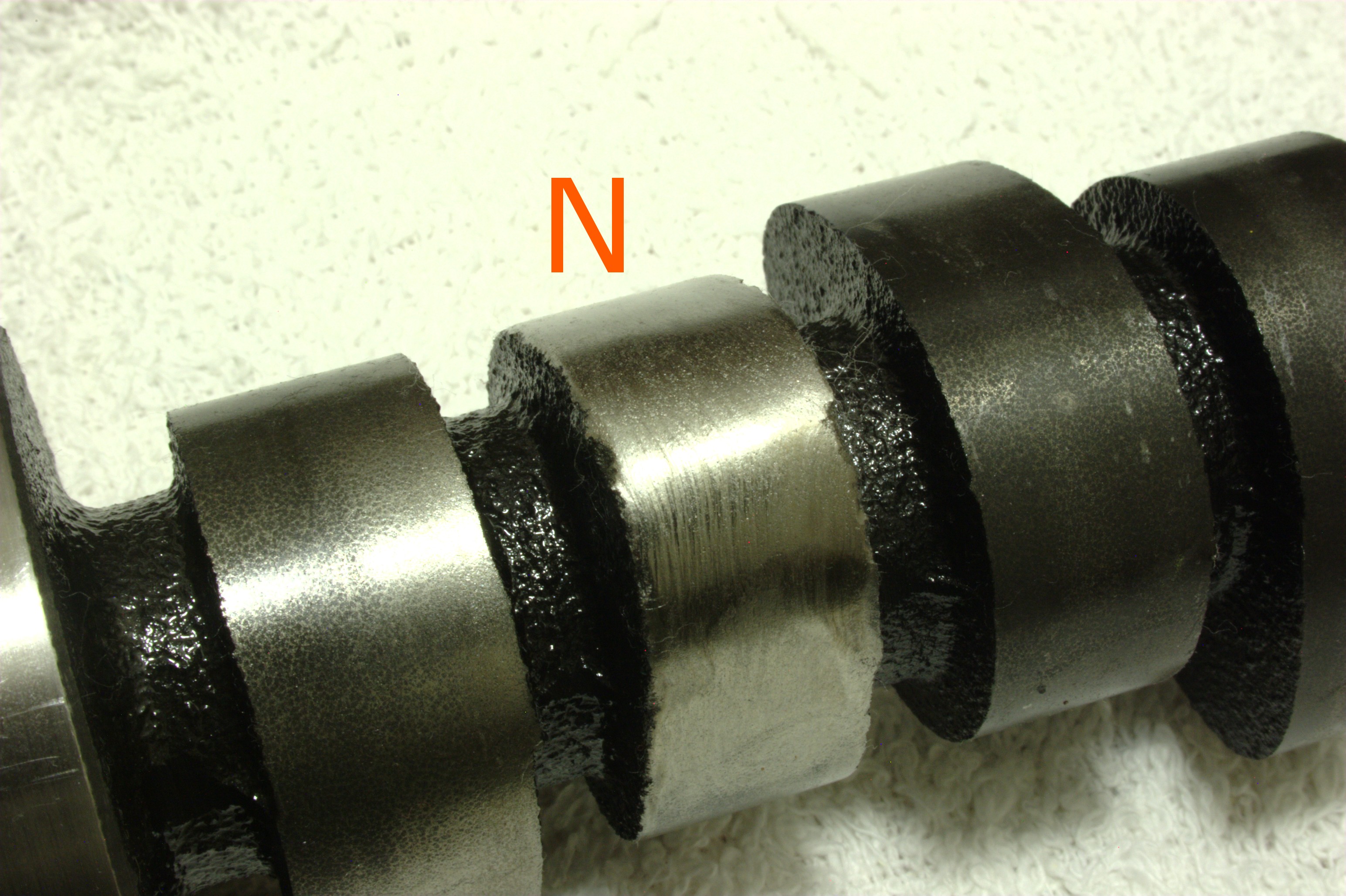

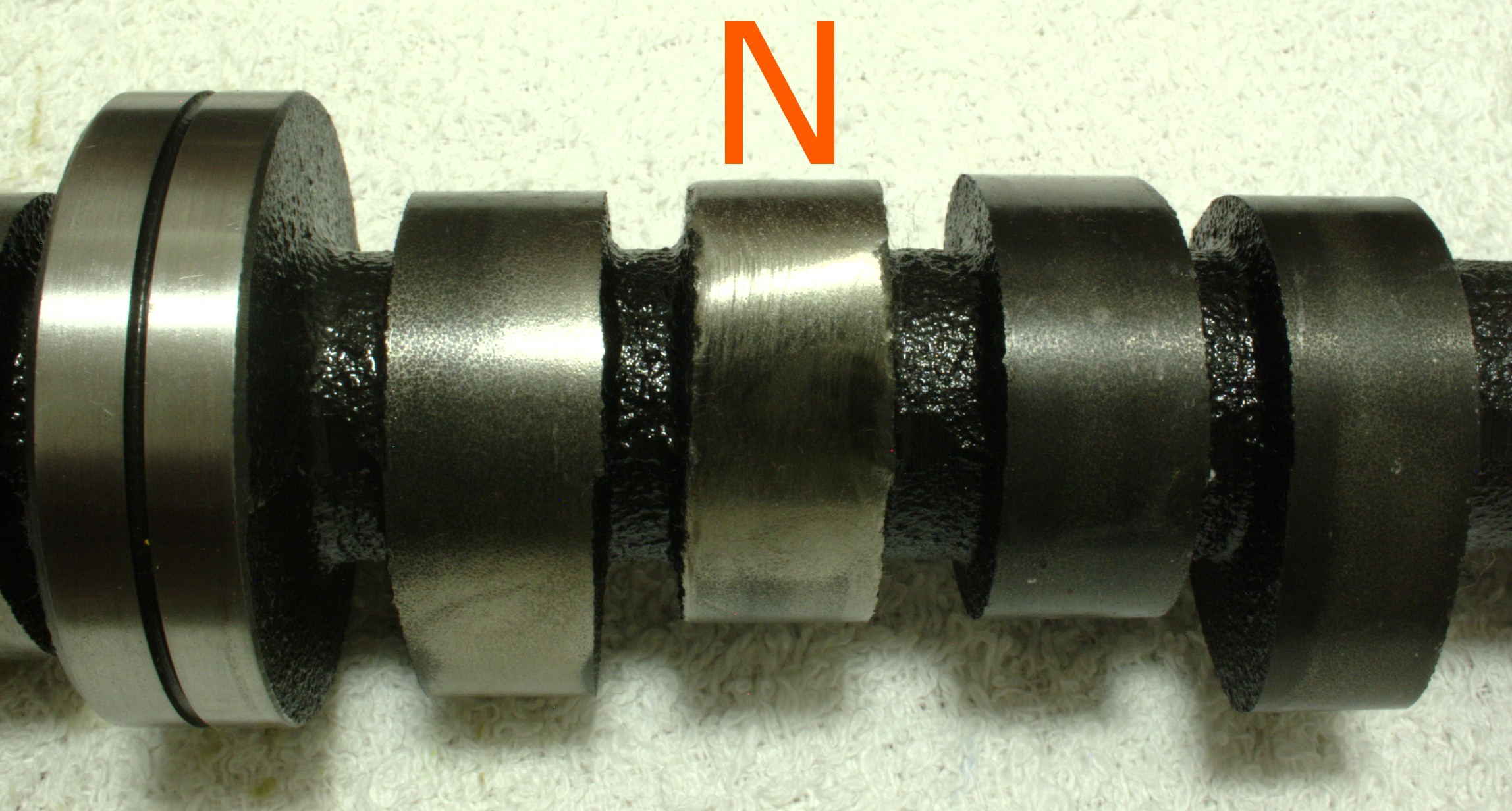

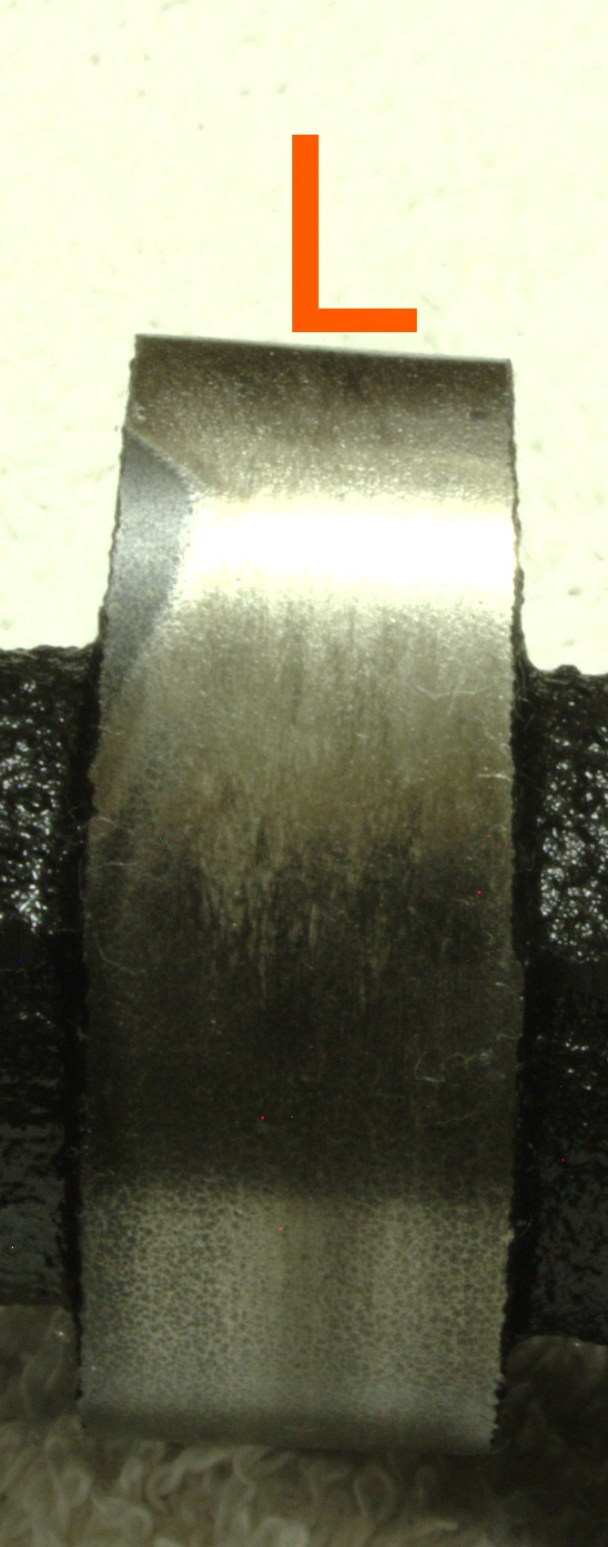

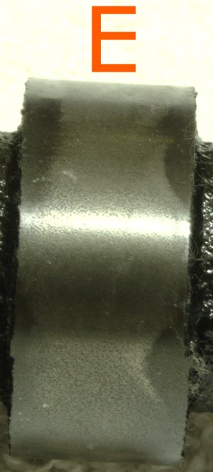

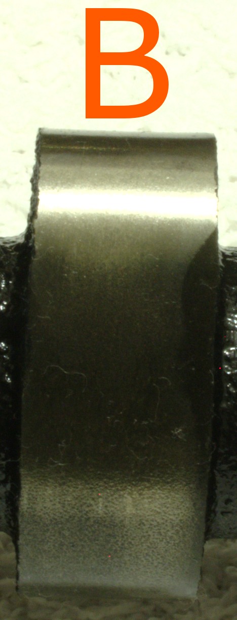

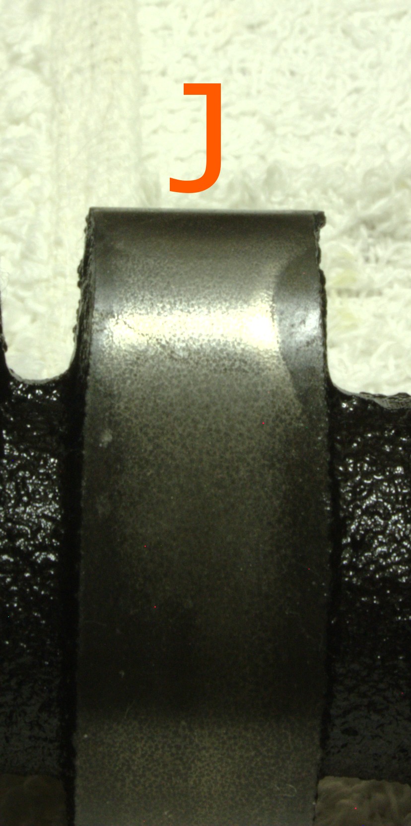

Here are the camshaft photos! Those of you who aren't inclined to wade through all the photos should scroll down to lobe "n." It's the worst off.
Lobe "n" has a lot of damage.

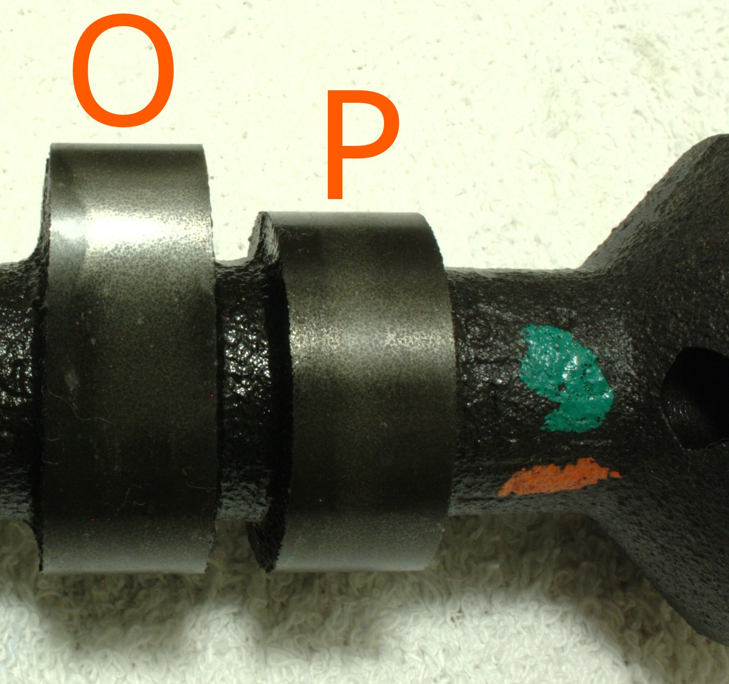

I've become lazy at the end, so here are "o" and "p" combined in single photos. Come to think of it, I could have done all of them this way and saved some time (oh well).

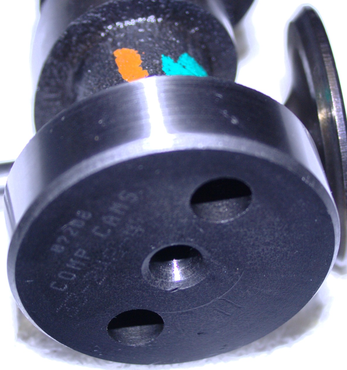

Here's the end with the writing on it. It says, "07208 COMP CAMS 33-248-4."
Thanks for the outstanding guidance!

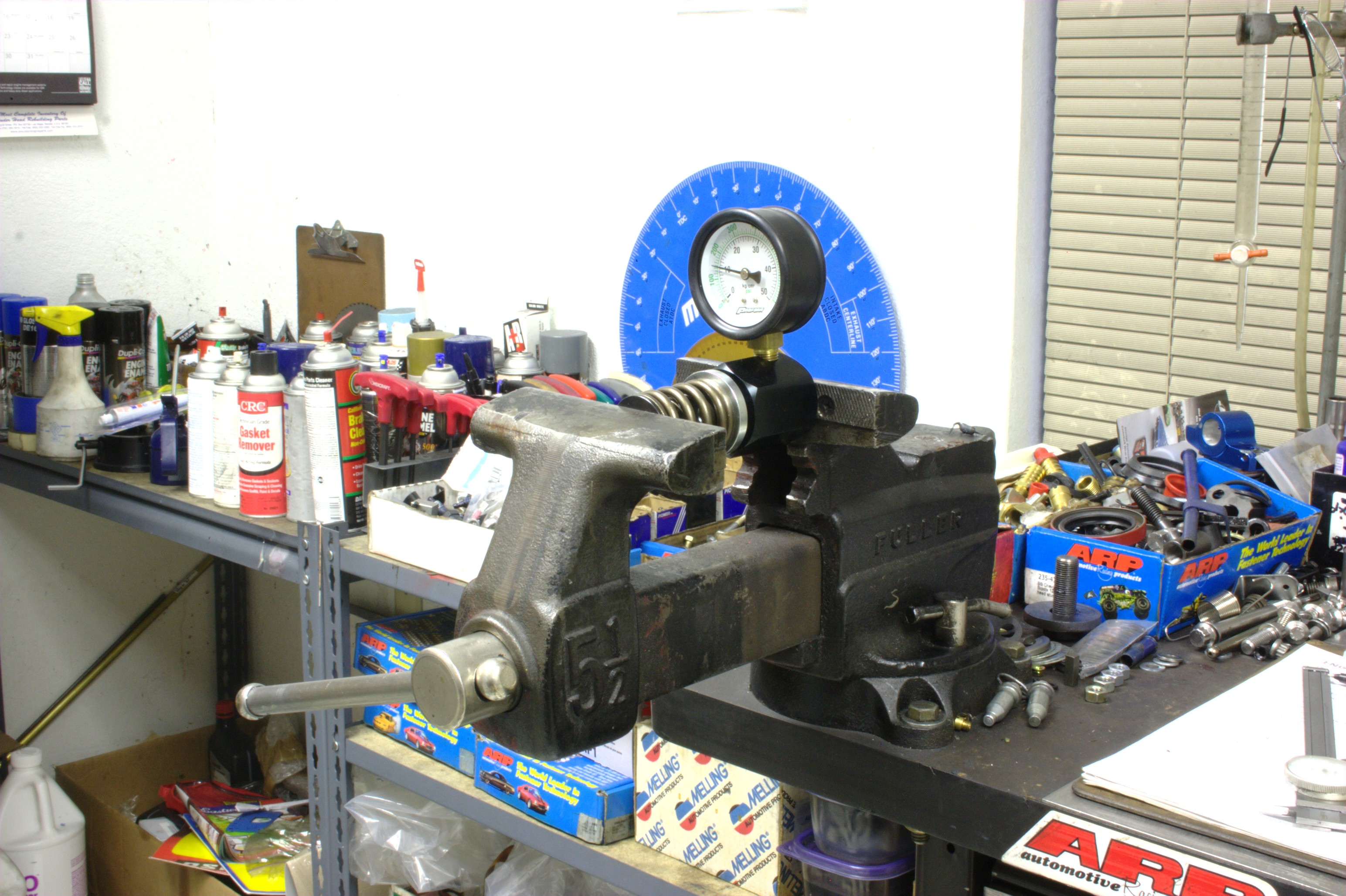

Here's Tom's setup for checking spring stiffness (or rate?). You can see that the gauge reads around 150, which according to Tom is far too stiff. I heard from Tom that this could have been a contributing factor in the cam failure!

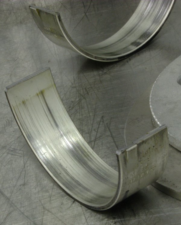

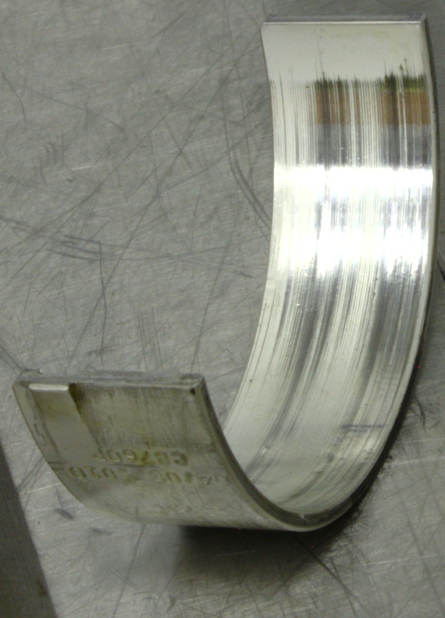

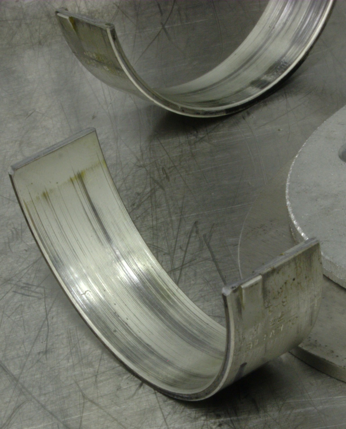

Here are a couple of thrust bearing shots. I don't recall exactly which bearings these are, but I'll bet you guys can tell just by looking! Tom noted the uneven wear patterns.
Here's the head that Tom left assembled.
Notice how the golden (is that copper?) washer under the valve spring is off-center. Many of them were way off center--I heard from Tom that this is not good.
And notice how for one valve, two of these copper washers were used! I heard from Tom that this was an attempt to make up for inadequate machine work on the head (if I understood him correctly).

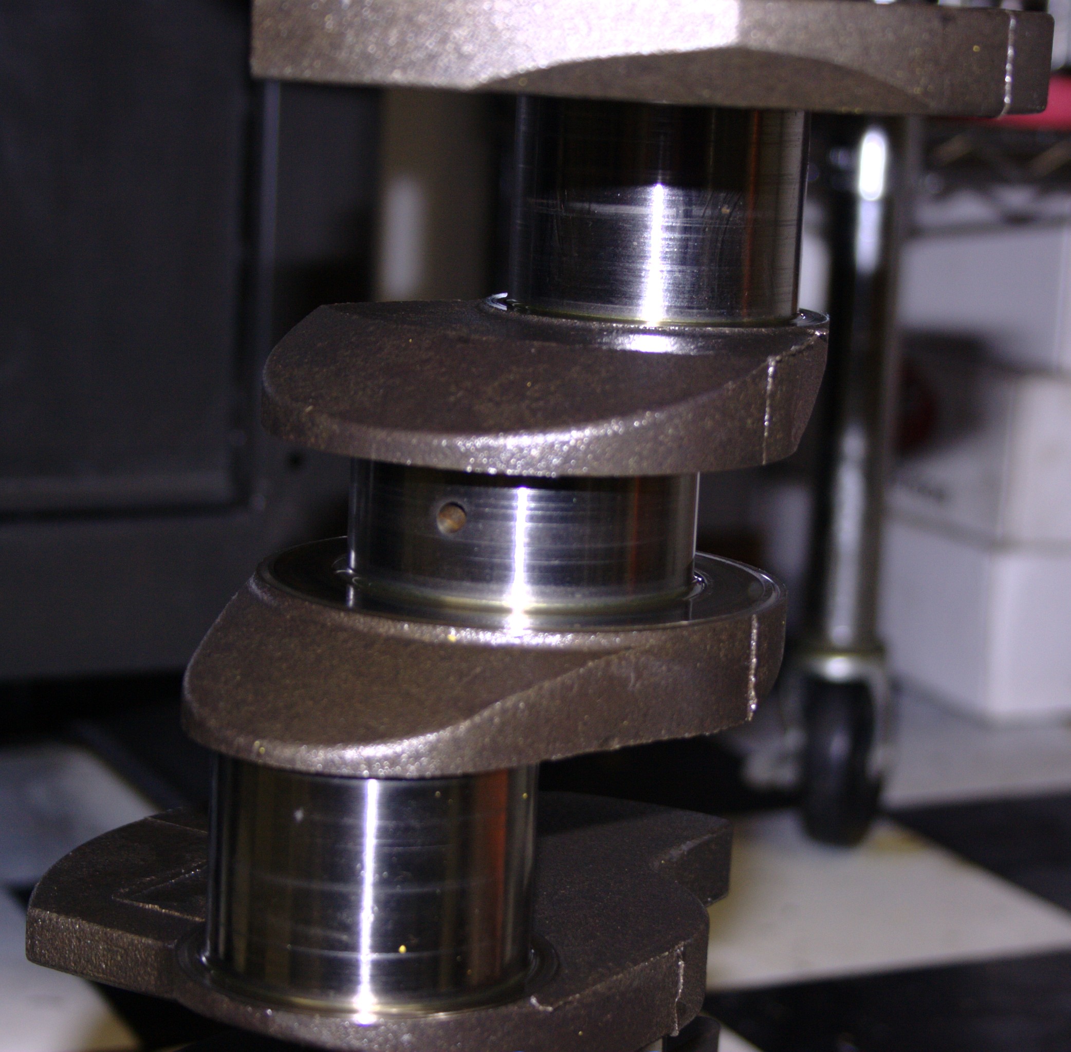

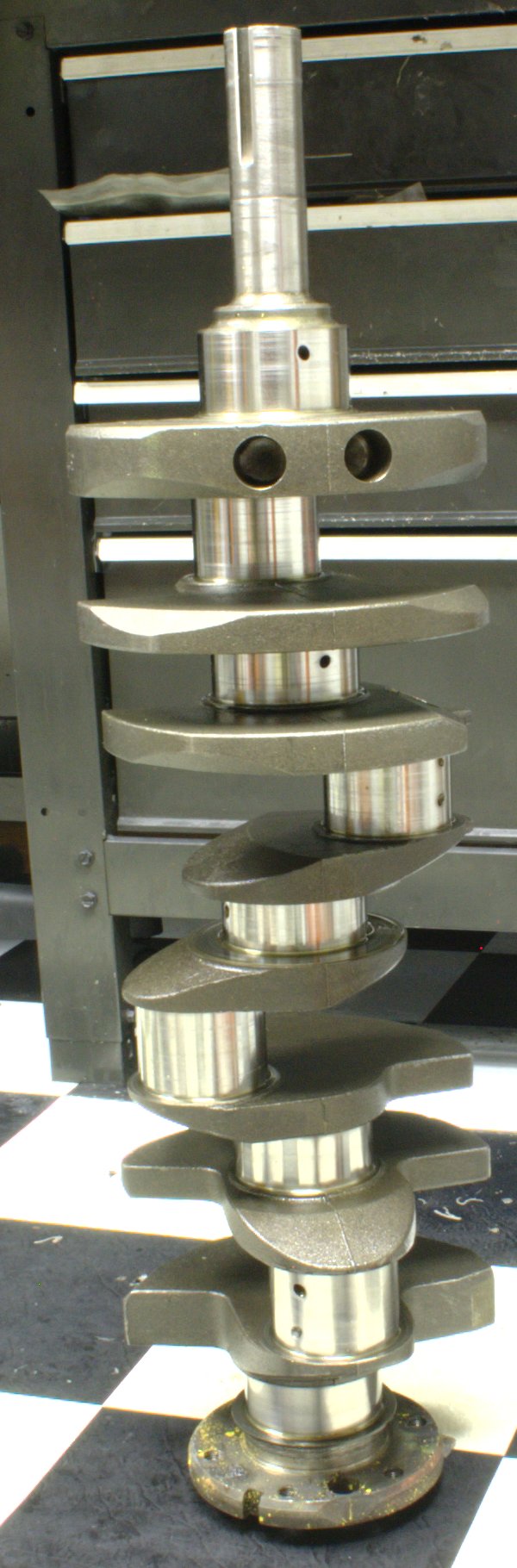

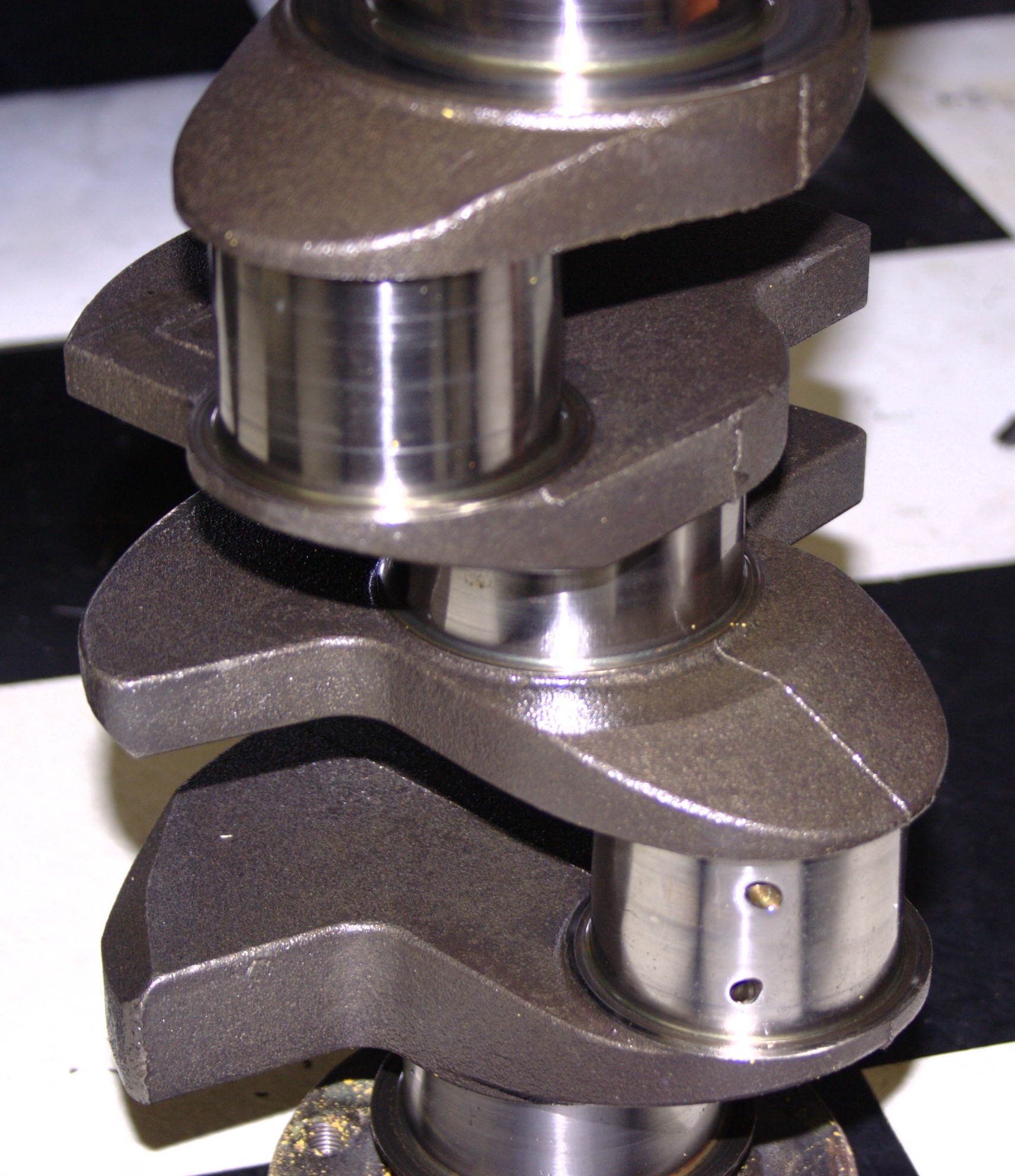

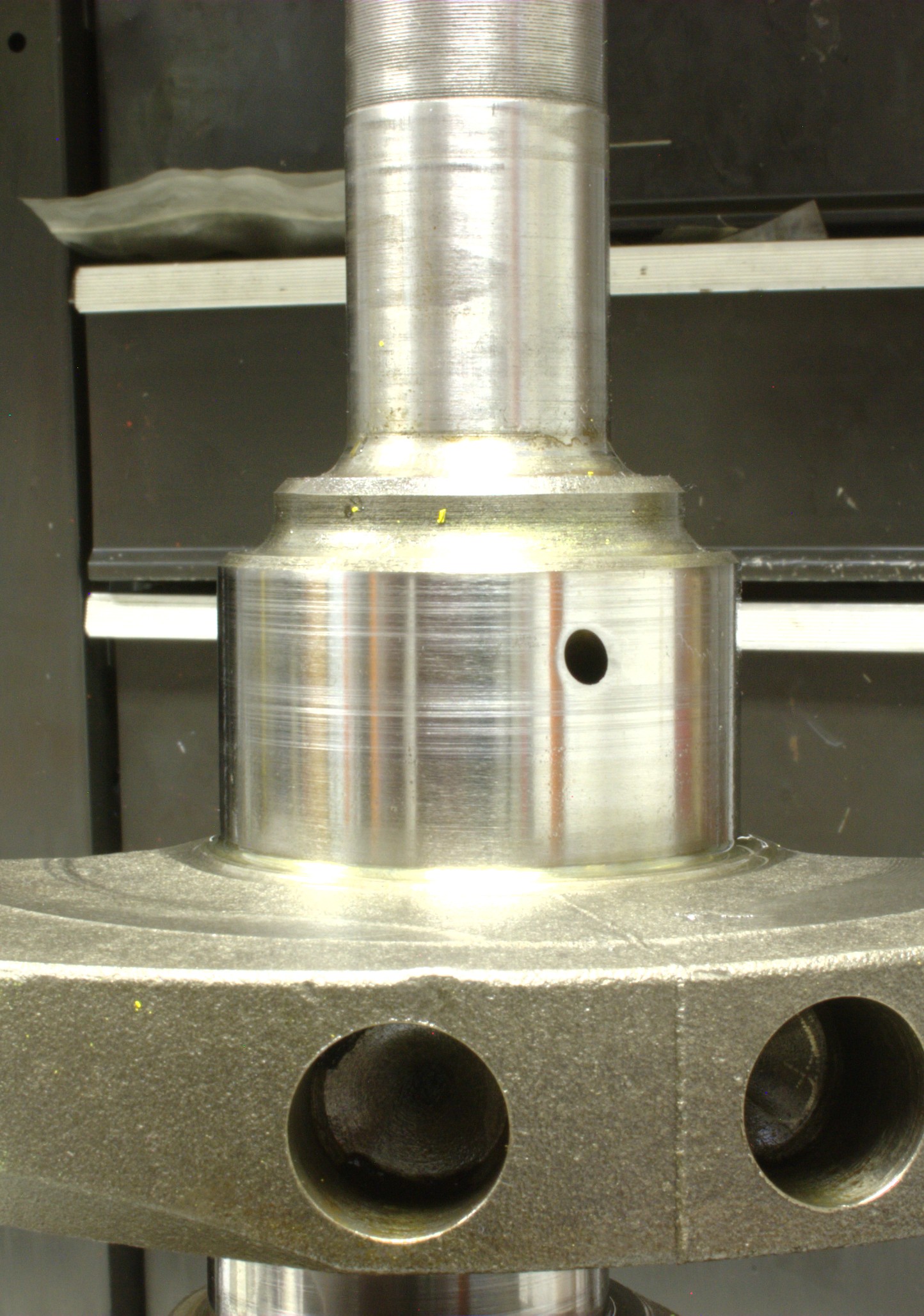

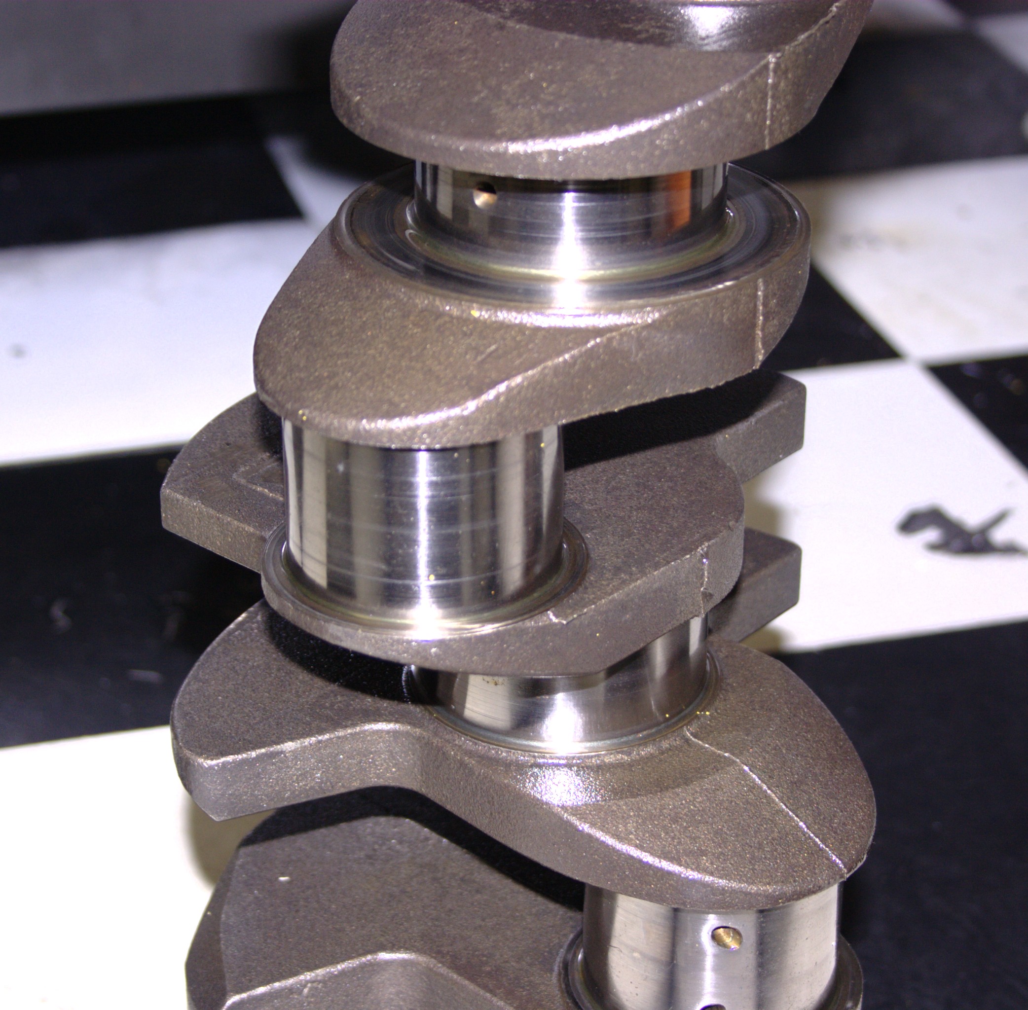

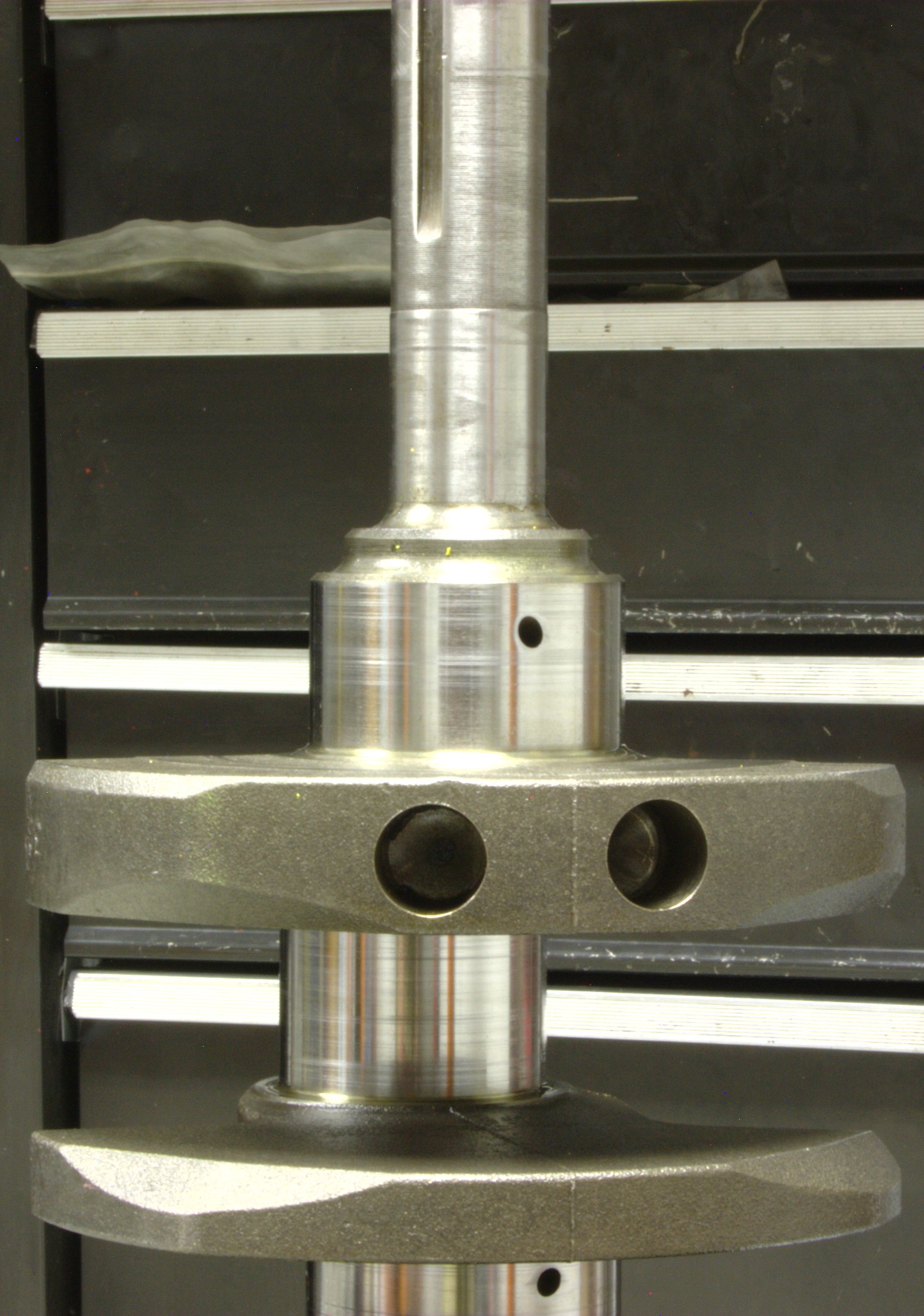

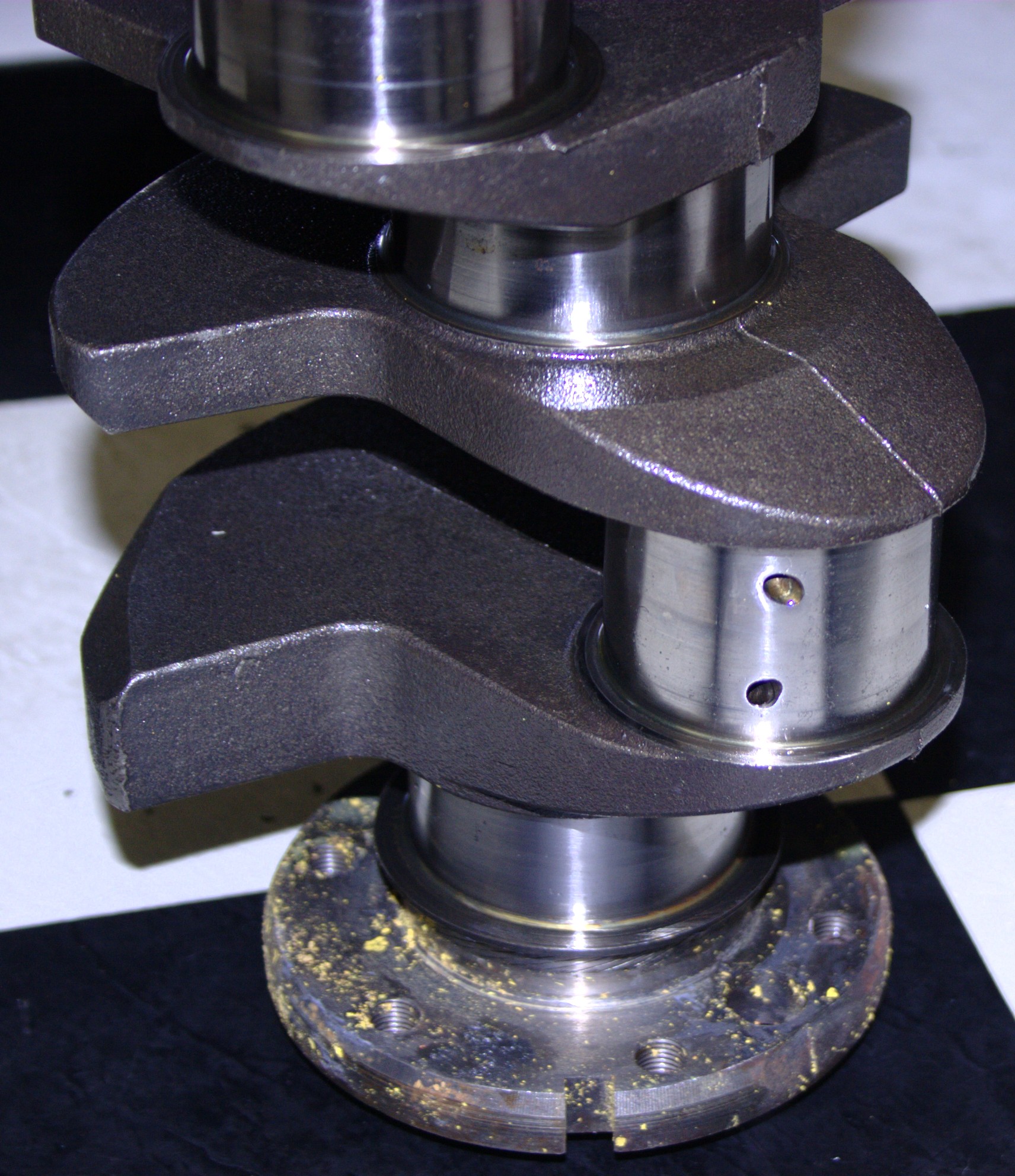

And here's the crankshaft. Tom said that it wasn't badly damaged, but it got scratched up enough to warrant being re-polished.
Here's a link to an image of the entire crankshaft, standing on end. Of course, we'll probably be more interested in the up-close photos that follow it.

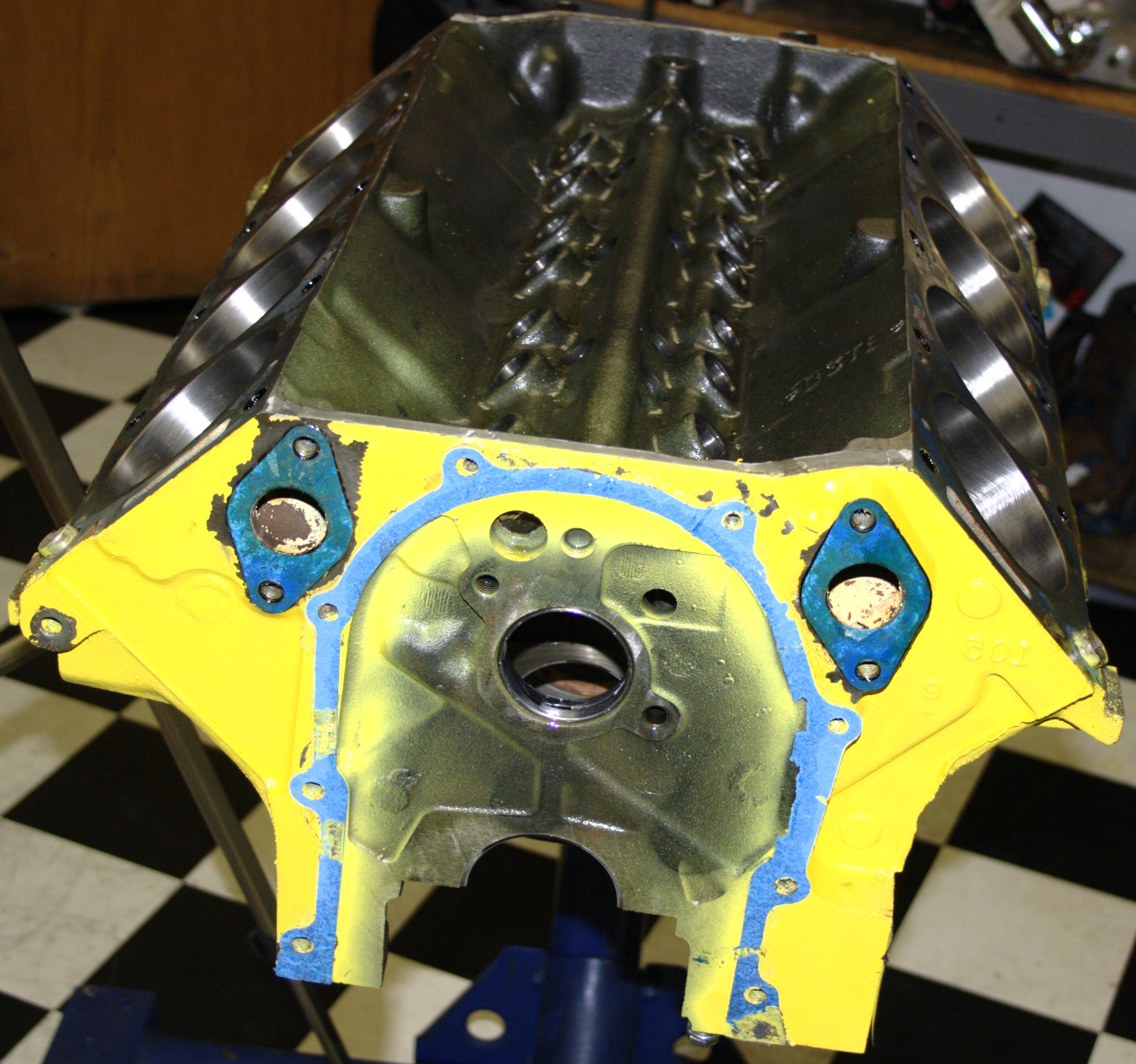

Here are a couple of really good shots of the cylinder walls! I overlooked these when posting my original photos of the walls.
And here are a few remaining photos. Since they don't pertain to any points we're discussing directly, I'm tossing them in here at the end.

BobbyFord wrote:Robroy,
Just some questions pertaining to the camshaft failure...
Has Tom measured the valve spring rate as it corresponds to that camshaft? Flat tappet cams have spring pressure guidelines for each cam. Valve seat pressure at installed spring height and valve spring pressure at maximum valve lift, as well as the correct spring clearance in terms of coil-bind.
Did your heads have dual valve springs (inner and outer valve spring per valve)? If so did you remove the inner valve spring for break-in purposes? Engine builders should and do recommend this procedure.
Did you use suggested break-in oil and cam break-in additive? Synthetic oils are not recommended for engine break-in. Also break-in additive is recommended by every camshaft manufacturer, such as GM EOS (engine oil supplement), Comp Cams #159, Crane Super Lube, etc.
Did Proformance Unlimited give you any literature on engine break-in procedure? If not, they should have. Premature flat tappet camshaft failure on break-in has been on the rise for many years. Proper break-in procedure literature should be provided by or recommended by every performance engine builder/shop.
Indeed, Tom measured the valve spring rates and found them to be way too stiff! I forget the exact figure but I have a photo of one of the springs on his measuring machine that I'll post shortly (the dial is included in the photo that shows the spec you're looking for, I think).
BobbyFord wrote:Did your heads have dual valve springs (inner and outer valve spring per valve)? If so did you remove the inner valve spring for break-in purposes?
Yes, they have the dual springs per valve. As to whether or not the extra springs were removed for break-in, I'm not sure. Proformance Unlimited did the break-in at their shop before shipping the engine to me.
